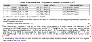

On page 17 of FDC2112 datasheet, how to calculate 1.8ms, 3.2ms, 0.75ms and the final 16.75ms? Could you describe the calculation process?
Hi Amy,
The calculations in the datasheet are incorrect and there is yet to be a new version released. Please refer to the FDC2112-Q1 datasheet for the correct calculations (page 16).
