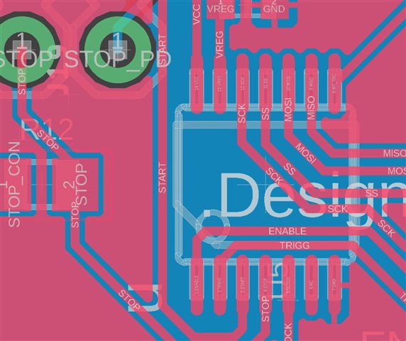

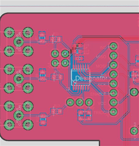

Schematics of the board :
Would be very grateful for any suggestions to resolve the issue. Thanks.
