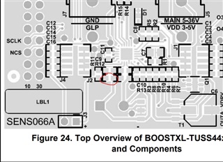

Can I check how do I set the TUSS4470 for measurement using bistatic configuration?

Thanks. Can I check where do i hook up the 2nd transducer that is acted as the receiver on the development board

i am thinking will it works if i connect my receiver transducer to INP and INN per below to do the receiving of signal while waiting for you to check out the actual connection procedure

Looks like J3 is used for bi-static configuration as seen in the schematic below.
In order to make sure that you are only receiving burst on only the RX transducer on J3 you will have to remove the 0 ohm resistor on R12 (circled at the bottom) which connects the transmitting transducer back into the input for monostatic configuration.

No worries glad to help out. It looks like no changes need to be made in the GUI in order for bi-static measurements to be enabled. The transducer will connect directly to the analog front end of the device which if the resistor mentioned above wad removed then it will be the only device in the signal path.
I am not quite certain about the way you are taking your measurements, if you are still using a round trip ToF method then the GUI will give you accurate distance measurements, but if you are using one transducer on one end and another transducer on the other end then this is not a round trip ToF calculation so the distance will be incorrect because the GUI calculates for round trip ToF. The ToF measurement will be correct, but if you want to calculate distance then you may use the distance provided by the GUI divided by 2. Note that this is only if you are using a detection method where the receiver is on the opposite side of the transmitter.
