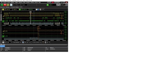

customer measured I2C AC timing and seen that write data hold time of 1 bit before ACK was 49.82nS, which would not meet the specification of TMP112 SPEC greater than 100nS.
because only the first 1 bit of ACK will be seen, is there any risk?
because of the I2C write tHD of customer control IC, DATA wil be between 2560nS~2600nS, which will exceed the TMP112 specification of 900nS, will there be problem with this TMP112?
