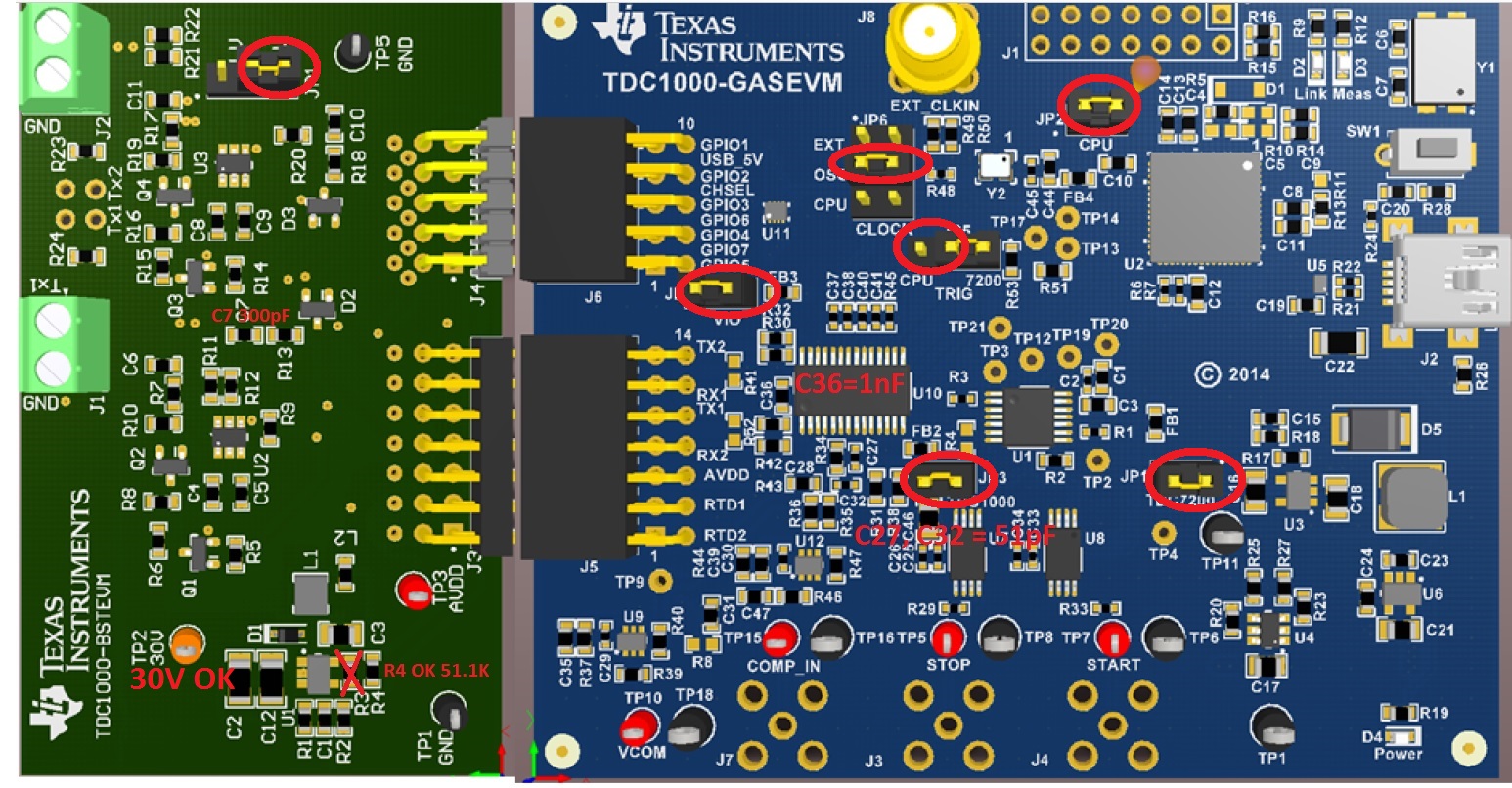

  • Uriel,
    Please share what's the jumper settings on your TDC1000-GASEVM. The board by default is set up CPU clock. Are you seeing the 30V TX excitation pulses properly? Do you see a echo on the COMP_IN terminal?
    Take a look at this posting
    e2e.ti.com/.../483410
    I explain in the above posting how to make sure at first you are seeing the TX excitation pulses at 30V properly. Let me know if you follow it and have questions. If needed, I can post an updated CONFIG file for your 1MHz transducer.
    Vishy

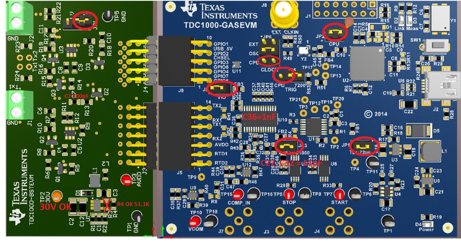

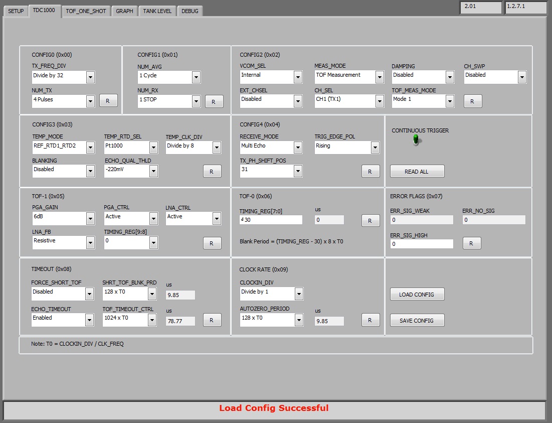

  • Vishy,
    This configuration have in the EVM
    This is the application configuration
    the sensor used is the below.
    www.steminc.com/.../ultrasonic-gas-flow-sensor-200-khz

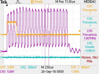

    This is what I get on the oscilloscope
    So far not been successful.
  • Uriel,
    Since this GASEVM board has been setup for 1MHz transducer, please use the enclosed configuration file

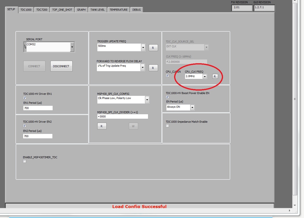

    A few things about this configuration file
    a) It assumes your GASEVM JP6 jumper is set as CPU clock, not onboard clock.
    b) Other jumper settings as you show above are fine
    c) I enclose above a config file. From the GUI, you can load this config file when you start to debug. It automatically sets up all the parameters and registers for  you. If you modify something, you can save and update the file as well. You do config file load and save operations by using "Load Config" and "Save Config" buttons of the TDC1000 (or TDC7200) tab of the GUI.
    c) After loading the config file, first you probe TX1 pin (J1) of the TDC1000-BSTEVM, and should see 20 30V pulses (1MHz freq). Please confirm you see this.
    d) You can also check GASEVM board J5.10. There you should see 20 3.6V pulses (1MHz freq).
    Once you get this going, then we debug the RX path.

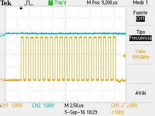

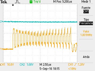

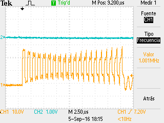

  • Vishy,
    Make the changes that indicated me, change the jumper JP6 to CPU Clock
    Load the configuration file that sent me,

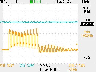

    The signal was generated in TDC1000-BSTEVM J1 it is as follows:

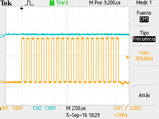

    Also in J5 pin 10 I get the signal by 20 pulses of 1 MHz.
    What are the next steps?
    Regards.
  • Uriel,
    a) At J5.10, the TX output 20 pulses is clean but at J1 it looks very noisy and seems to be riding on something. Please debug this. May be some modification on the BSTEVM is causing this issue? Do you have transducer connected at TX1? How is it without the transducer. Try a board without any modification and see.
    b) For debugging RX path, please use the enclosed config below as a starting point. Keep water level fixed to say about 100us TOF. Use the equation TOF = 2 x D / C, where C is the speed of sound of sound in water (1480m/s), to find the corresponding level D. As explained in the app note SNAA270 observe if you are receiving a proper echo at 100us from the start pulse. You can observe START, STOP and echo pulses at TP5, TP6, and COMP_IN terminals and debug your setup.

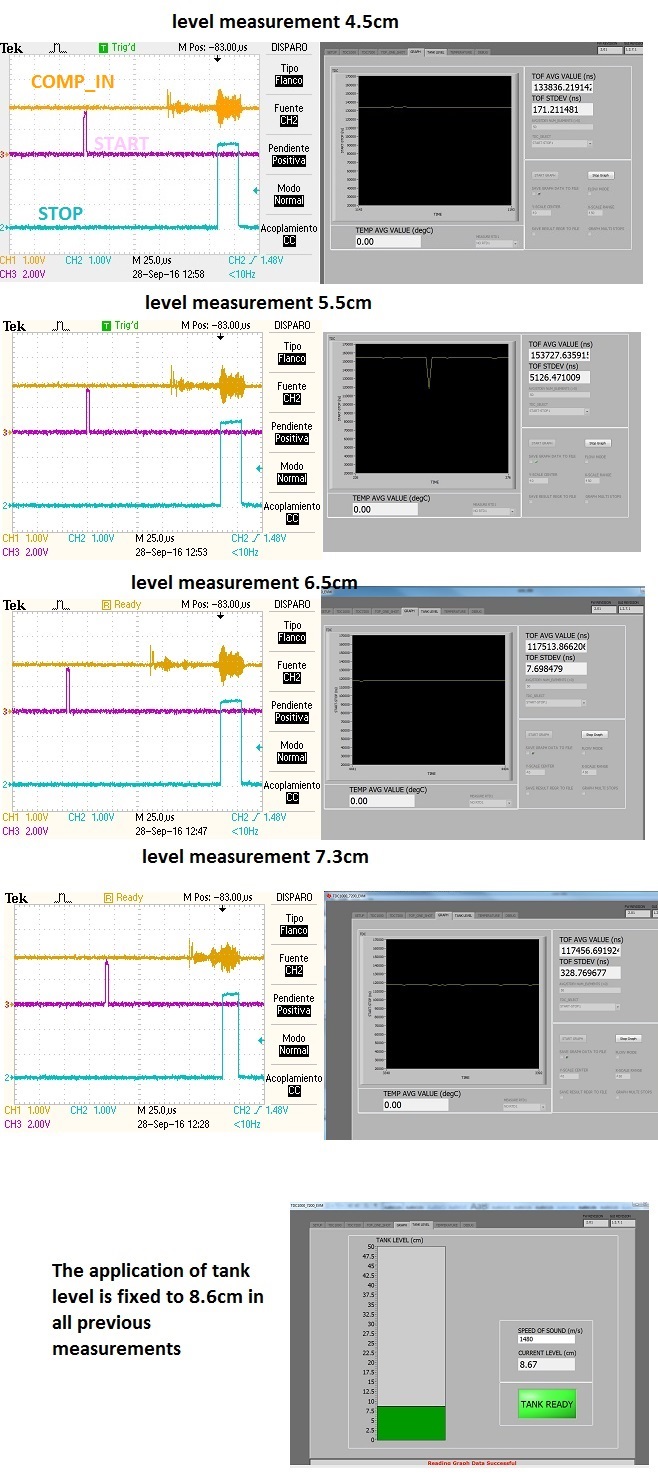

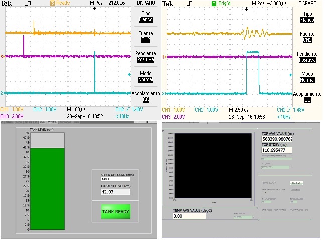

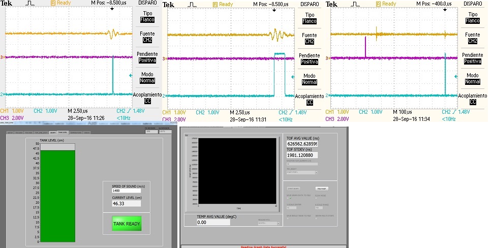

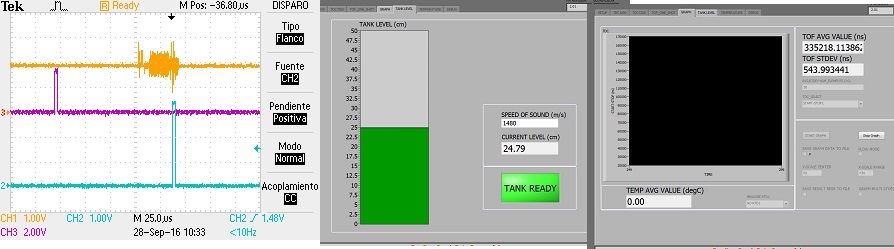

  • Hello Vishy,
    I have obtained a better response with the parameters configured as shown and the configuration file attached.

    The configuration data are as shown in the images.
    And the configuration of the EVM is as shown
    If frequency 1MHz as it is shown.

    I modified parameters ECHO_QUAL_THLD, PGA_GAIN and NUM_TX and I failed to take measurements in more than 46cm and less than 8.6cm.
    regards

  • Uriel,
    a) I think autozero period of 32us is interfering with measuring less than 8.6cm. One way to go around this is to set FORCE_SHORT_TOF as "Enabled" in TIMEOUT (0x08) register. Keep SHRT_TOF_BLNK_PRD as 16us or 8us and try. This selection puts TDC1000 in short time of flight measurement mode. This has the advantage of turning on the receiver and allowing the common mode to settle before TX pulses are sent.
    b) Other option is to change the 13MHz oscillator to 8MHz and use it as the TDC_CLK_SOURCE in Setup Tab. Then you have to change TX_FREQ_DIV in TDC1000 CONFIG0 reigster as "Divide by 8". This would also reduce autozero period and in this case you can still be in Standard time of flight measurement mode. You can read about standard and short tof measurement mode and their differences in TDC1000 data sheet.
    c) Let me know if this experiments have any impact on >46cm measurement. You basically need higher excitation as you go longer. Make sure there's no energy loss in your transducer mounting.

  • Also, if you can, post some scope shots of the signals at START, STOP and echo (COMP_IN). Thanks, Vishy
  • Vishy
    Here are the pictures
    These are less than 8.5cm where this error, I can see the stop and echo, but the measurement is wrong in the application
    With the configuration sent in the previous pregunata I get the following.
    In previous measurements I get the measurement problem ... I see the STOP and echo..
    The following measurements the error is minimal.
    For 24.6cm measured in the application I get this data.
    For 41.6cm measured in the application I get this data.
    For 44.6cm measured in the application I get this data.
    I am here very close to the maximum level that I can measure.
    If the water level increase I no longer see the STOP and ECHO on the oscilloscope.
    ECHO signal aplitud decreases as the water level increases, this means that I have to increase the voltage over 30VDC?
    Right now I'm checking the measurement of less than 8.5cm with the recommendations made.

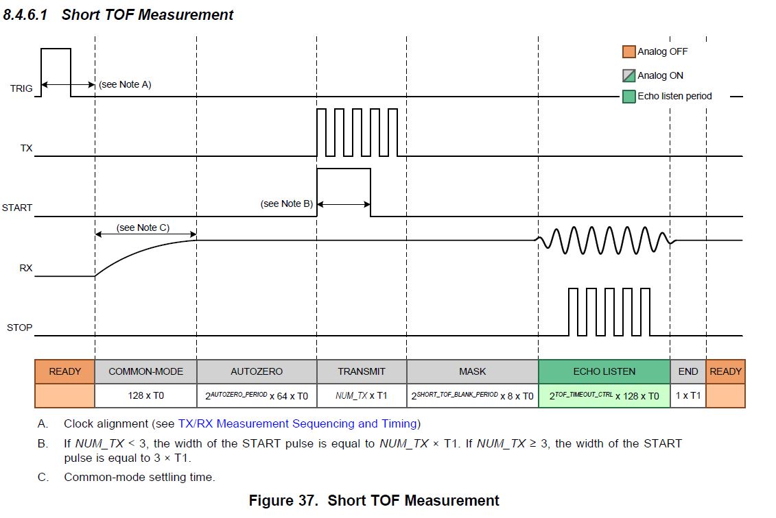

  • Thanks for the scope shots. Using Short TOF measurements would definitely help you measure less than 8.6cm. As you are using 2MHz clock, it takes 128 cycles (= 64us) for the common mode to settle.  By using short TOF this settling period is done before the transmit pulses are sent and START is generated. See picture from DS below.
    When using short time of flight, you can experiment with the auto zero period, so the transducer ringing following the TX pulses is reduced. This can help clean up your receive echo for close targets as well.
