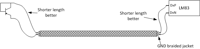

I found an app note for the LM83 that is updated from the old thru hole 2N3904 to a surface mount 3904. Can you simply connect a transistor as shown on the datasheet to the LM83 over, say, 15 inches of wire (cables between 2 different assemblies) and have it simply read the temperature?
