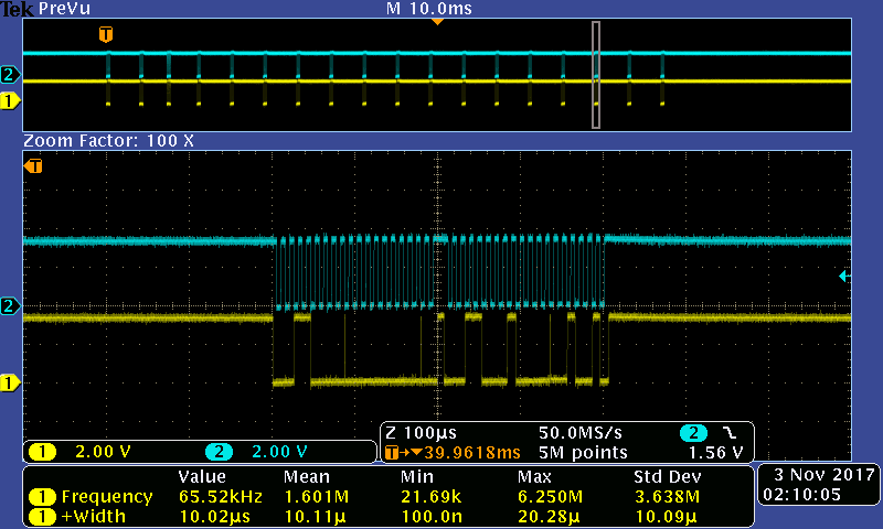

Hello, I have a problem getting a meaningful *local* temperature reading from LM83.  It is read back zero most of the time while the *remote* temperature sensing always works.  I checked I2C transactions on oscilloscope and was not able to catch any problems.  The interesting observation is that the read back value is not zero all the time.  Sometimes, it is 1 or 2 or 3 but it seems to be always in small values.  Any comments will be appreciated.  Thanks.

    Could you please provide me the scope photo just for local temperature reading only?
    Aaron
  • Hi, Aaron,
    The good one shows 26 degrees Celsius.  Please see attached Read_Local_Value__Good_26.png.
    The bad one shows 4 degrees Celsius.  Please see attached Read_Local_Value__Bad_4.png.
    The bad one shows 0 degrees Celsius.  Please see attached Read_Local_Value__Bad_0.png.
    They are all read back from the same register of the same LM83 chip.
    Francis
    Good 26 degrees Celsius
    Bad 4 degrees Celsius
    Bad 0 degrees Celsius
  • Hi Francis,
    Thank you for provding the scope photos. How many device attach to the same bus? According to your scope photo, the slave ID address that you sent to the device isn't specified in the datasheet. It looks like you are sending a 0x30, but the device only works with the following addresses 0x18, 0x19, 0x1A, 0x29, 0x2A, 0x2B, 0x4C, 0x4D, 0x4E in 7-bit. Could it be you were reading a different device that coincident connected to the same communication line?

  • Hi, Aaron,
    Please refer to the attached annotated image with all the bits labeled.  Note that the address that I used is 0x18.  Sorry about the poor resolution of the scope plot.
    Note that:
    A - ACK
    W - Write bit
    R - Read bit
    N - NACK
    And the correct temperature of 26 deg. C. is returned in this case.
  • Hi Francis,
    Thank you for decoding the waveform for me. You haven't answer me the number of devices on the bus. On the bad temperature reading, there are also glitches in the middle of the data read. It shoud not be there. If you take a closer look at the low side of the glitches, there is something happening. It looks like a bit higher than the rest of waveform.
    Aaron
  • Hi, Aaron,
    You are correct that there is a suspicious glitch in the middle of the data readout. This gives me a direction to look deeper into this problem. I am still looking into it but I am quite confident that LM83 is not the root-cause of the problem.
