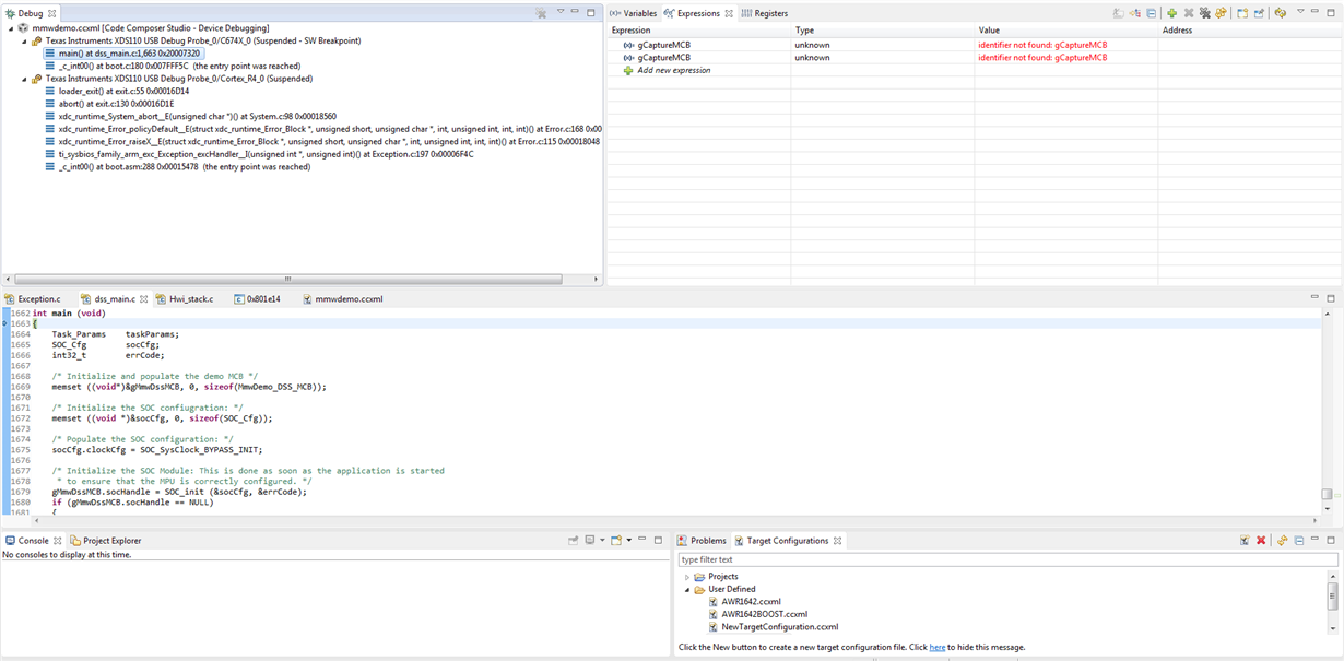

I have followed the reference guide to a T for setting up the tracking monitoring system. I have built the mmwave environment and went to CCS to load the executable and the DSS main file is loaded correctly, but the problem is coming with the MSS main file. It will not load correctly and so I can not send a configuration to the mmwave device to run it and was wondering if someone could help me out. A picture of my CSS with the files loaded is shown below.

    A few questions:
    1) Can you load the binaries that are packaged in the zip file?
    2) Are you sure that all the tool versions are those shown in the 1.0.0.5 SDK's Release Notes (or on slide 5 of the demo's Getting Started Guide)?
    3) Are there any peculiar warnings thrown by the R4 compiler or linker?  If you inspect the build output, can you see the correct tool versions being referenced?
    4) Have you flashed the EVM with the CCS debug image onto the IWR1642 as shown in slides 12-15 of the Getting Started Guide? And you've removed the SOP2 jumper once flashed?
    If all the above is okay, try doing a "gmake clean" followed by "gmake all" and try it again.
     -dave
