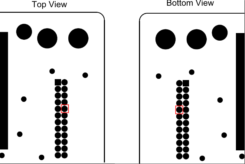

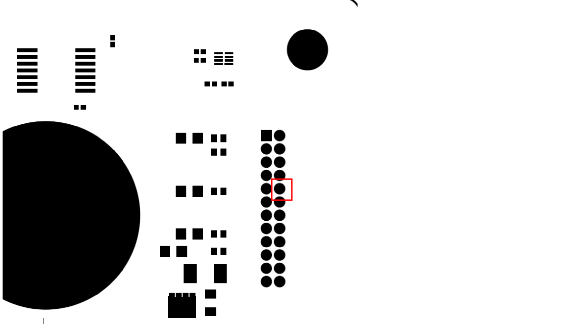

  • Peter,
    You need to check on ILLUM_P (not ILLUM_EN_P). It is available on the connector connecting the illumination board to the sensor board.
    This is where you will find it on the illum board (Top side, J1, pin 10):
    This is where you will find it on the sensor board (Bottom side, J1, pin 10):
    Since we use an accurate crystal on board, frequency calibration can be skipped. Other errors will be more dominant.
