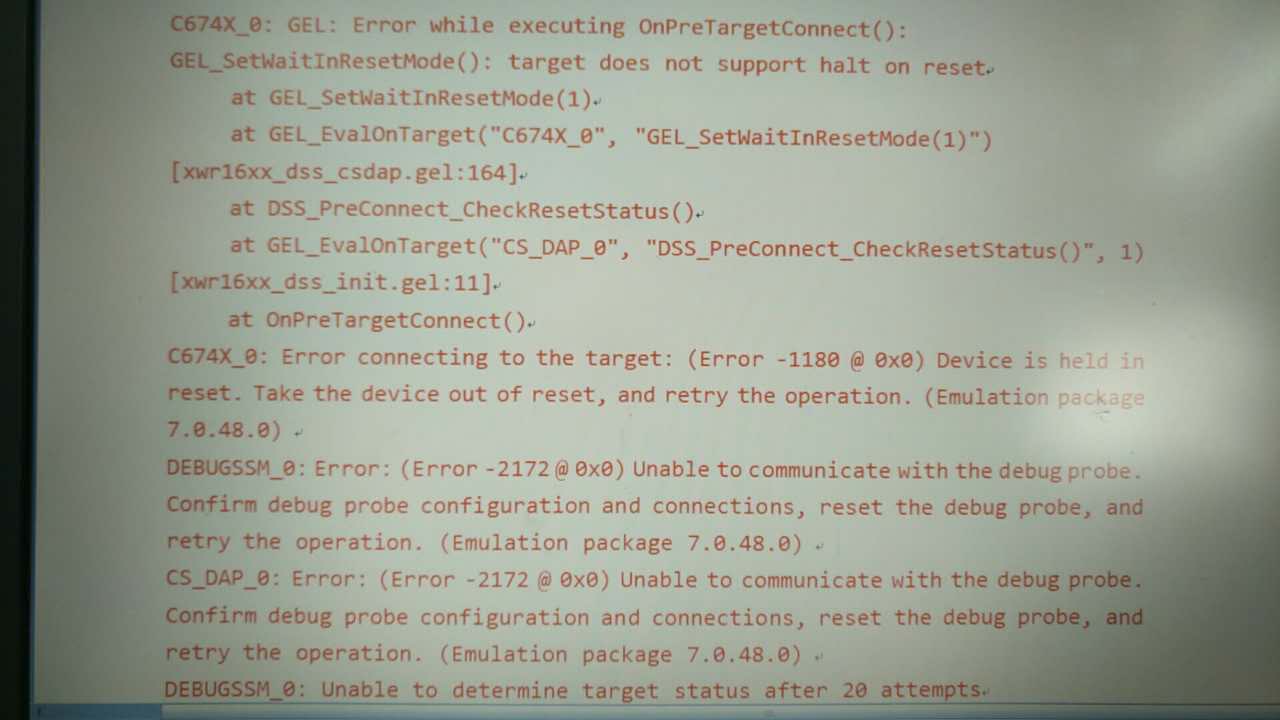

   My customer is testing their own AWR1642 board. They are using a Specturm Digital XDS560V2 STM debug probe to connect AWR1642. They found the R4F can be connected correctly, but could not connect C674x. The error is as below.
Do you have any suggestion on it?
Adam

    Have they selected the right DSP code C6748 ?
    -Raghu
  • Hi Raghu,
       Yes, the core is set correctly.The JTAG test connection in ccxml can pass, but when they connect the C674x. Above errors happen in GEL_EvalOnTarget("C674X_0", "GEL_SetWaitInResetMode(1)");.  What is the meaning of the errors above?

  • Hello Adam,
    Can you confirm that they have flashed xwr16xx_ccsdebug.bin or demo application to AWR1642 device and switched the device to SOP-4 mode before connecting to DSS JTAG?
    Jitendra
  • Hello Jitendra,
    Thanks for the good suggestion. I am still checking it with customers.
    Adam
