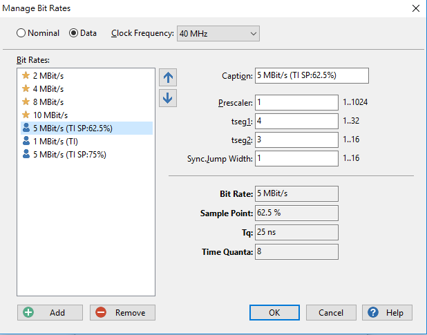

When I use CANFD in Type_CLASSIC, I use PCAN with this Bit Rate. (Nominal Bit rate = 1M Hz)
I can receive data from AWR1642.
But
When I use CANFD in Type_FD, I use PCAN with this Bit Rate. (Nominal Bit rate = 1M Hz; Data Bit rate = 5M Hz)
I can't receive data from AWR1642.

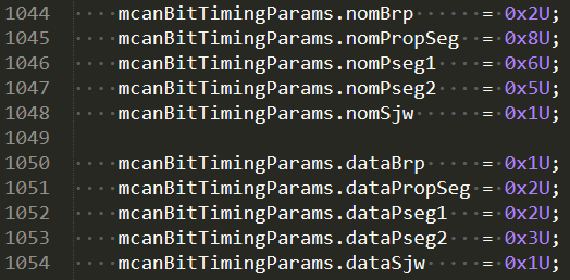

I just change
from CANFD_MCANFrameType testFrameType = CANFD_MCANFrameType_CLASSIC;
to     CANFD_MCANFrameType testFrameType = CANFD_MCANFrameType_FD;
What is my negligence?

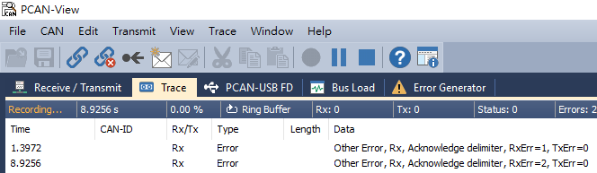

  • I have removed R4 and R6 and mounted R11 and R12.
    When I use CANFD with testFrameType = CANFD_MCANFrameType_CLASSIC
    It is OK for PCAN and AWR1642.
    They all can receive/transmit each other.
    But When I use CANFD with testFrameType = CANFD_MCANFrameType_FD.
    They can't receive/transmit each other.
    Below is my bit rate in PCAN.

    Do I still need to change what in main.c(C:\ti\mmwave_sdk_01_01_00_02\packages\ti\drivers\canfd\test\xwr16xx)?
  • Hello JuiYang Chi,
    Have you selected the CAN-FD option in the PCAN ? If you do not select it, the CANFD frames will not be received/transmitted.
    -Raghu
  • Hi Raghu:
    Yes, I have chosen CANFD on PCAN.
    But it say below

        /* Configuring 1Mbps and 5Mbps as nominal and data bit-rate respectively
            Prop seg: 8
            Ph seg 1: 6
            Ph Seg2 : 5
            Sync jump: 1
            BRP(Baud rate Prescaler): 2
            Nominal Bit rate = (40)/(((8+6+5)+1)*BRP) = 1Mhz
            Timing Params for Data Bit rate:
            Prop seg: 2
            Ph seg 1: 2
            Ph Seg2 : 3
            Sync jump: 1
            BRP(Baud rate Prescaler): 1
            Nominal Bit rate = (40)/(((2+2+3)+1)*BRP) = 5Mhz
        mcanBitTimingParams.nomBrp      = 0x4U;
        mcanBitTimingParams.nomPropSeg  = 0x8U;
        mcanBitTimingParams.nomPseg1    = 0x6U;
        mcanBitTimingParams.nomPseg2    = 0x5U;
        mcanBitTimingParams.nomSjw      = 0x1U;
        mcanBitTimingParams.dataBrp     = 0x1U;
        mcanBitTimingParams.dataPropSeg = 0x2U;
        mcanBitTimingParams.dataPseg1   = 0x2U;
        mcanBitTimingParams.dataPseg2   = 0x3U;
        mcanBitTimingParams.dataSjw     = 0x1U;
        /* Configure the CAN driver */
        retVal = CANFD_configBitTime (canHandle, &mcanBitTimingParams, &errCode);
            Prop seg: 8
            Ph seg 1: 6
            Ph Seg2 : 5
            Sync jump: 1
            Prop seg: 2
            Ph seg 1: 2
            Ph Seg2 : 3
            Sync jump: 1
        mcanBitTimingParams.nomBrp      = 0x2U;
        if (retVal < 0)
            System_printf ("Error: CANFD Module configure bit time failed [Error code %d]\n", errCode);
            Prop seg: 8
            Ph seg 1: 6
            Ph Seg2 : 5
            Sync jump: 1
            Prop seg: 2
            Ph seg 1: 2
            Ph Seg2 : 3
            Sync jump: 1

        /* Configure the divide value for MCAN source clock */
        SOC_setPeripheralClock(socHandle, SOC_MODULE_MCAN, SOC_CLKSOURCE_VCLK, 4U, &errCode);

  • Thanks Raghu
    The resolved the issue.
