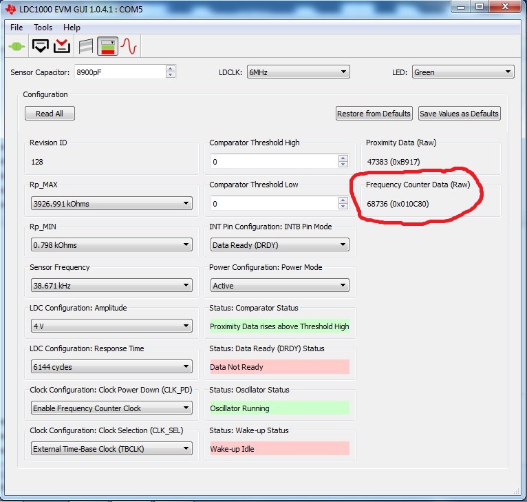

7. I chose the sensor frequency 20% lower, i.e. about 38 kHz (attached)

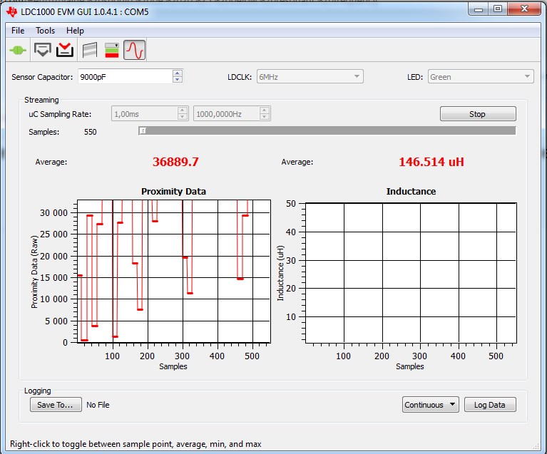

8. When I pressed "Start", then I have a proximity data that goes off scale! (see attached images)
Why does this happen and what did I do wrong?
  • Hi Victor,
    It looks like the sensor is oscillating, as you are getting an inductance measurement. Did you set the CFB filter capacitor value? Refer to section 8.1.3 of the datasheet for instructions on how to do that. The value of CFB needs to be set for each sensor design. Also, the CFB cap is a function of the RPMIN and RPMAX settings.

    I soloed the CFB capacitor, it turned out 680 pF. But still, in the program the value of the proximity data goes off scale.
    Help me figure out what's wrong.

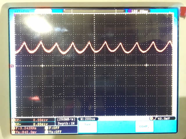

    Occillation on LC tank, 1 pin oscilloscope on ground, 2 pin - on pin LC tank
    Natural frequency = 47.62 kHz

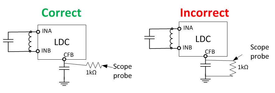

    Voltage on CFB pin (added capacitor 680 pF) across 1kOhm resistor on oscilloscope pin:
  • Hi Victor,
    Please clarify how did you probe the CFB node with the scope? The way you described the measurement is a bit ambiguous. Refer to the picture below:
    The sensor scope trace looks good. Can you get a scope trace of the CFB trace showing about 2ms/div?
    ChrisO

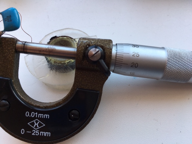

    3) Do you have access to a VNA or impedance analyzer? I would like to understand your sensor better. It looks like your sensor is an air core, correct?
    When you say the wire is 0.2mm, is that diameter or area?
    ChrisO
  • Hello, ChrisO!
    1. Set Rp_max = 981.7 kOhm, the peak-peak voltage on the CFB 1V, the proximity is off scale (see in the video).
    2. The original sensor works well (see video).
    3. I do not have an impedance analyzer, but there is a RLC meter. With the help of an oscilloscope I measured the resonant frequency and the resistance active at the resonant frequency. Results of measurements in my first post. The coil has an air core - look at the video.
    4. Wire diameter (not area, area measure in mm^2) with insulation 0.21-0.22 mm, without insulation - about 0.2 mm, see the photo below:

    I calculated that for Fsensor = 47 kHz, for RESPONSE_TIME = 6144 and Fext = 6 MHz, the Fcount should be:
    f = (6 000 000 * 6144) / (3 * 47 000) = 261 000
    But in our measurements (when you press the "Read All" button) was only 68736 !:
    I began to change the values ​​of Rp_min and Rp_max so that the value of Fcount was near to the calculated value of 261,000, and I achieved at 7.14 kΩ for Rp_min, and Rp_max for almost any, but not less than 7.182.

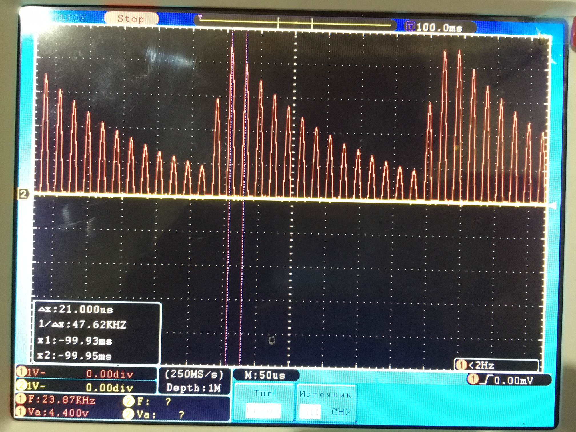

    Oscillogramm voltage between INA (INB) when Rpmin=0.798 kOhm Rpmax=3926.991 kOhm:
    Oscillogramm voltage when Rpmin=0.798 kOhm Rpmax=981.784 kOhm
    Oscillogramm voltage when Rpmin=0.798 kOhm Rpmax=16.16 KOhm
    And also:
  • Hi Victor,
    That last oscilloscope trace you provided was very helpful; I am wondering if the watchdog is not set properly. Please try reduce setting for the watchdog frequency (the GUI field sensor frequency) to <10KHz.
    Also, try using a larger value for the RPMIN setting - please try RPMIN set to ~3K. Please make sure that the CFB signal has the correct amplitude, as you have done previously. I would like to reduce the slope on the rising edge of the sensor signal.
    Please provide a scope picture of the new the sensor signal on the longer timescale (like the last picture you provided).
    ChrisO
