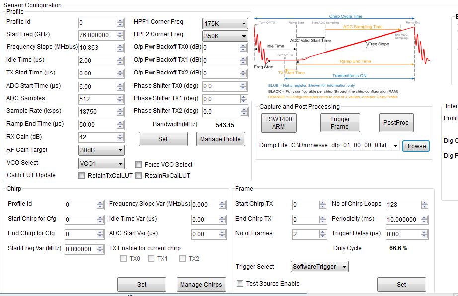

  • Hi Akash:
    Thank you so much for your reply. I am using the HPF1 and HPF2 with 175kHz and 350 kHz cut-off frequency respectively.
    The settings used to capture the data are attached with this message.
    RJ
  • Hello
    Due to the DFE filtering of 90% signals beyond 17.8Mhz are not usable within the system. In your graph with all of the Tx turned off, The receivers have a noise profile, convolved with the digital filters. The Rx LNA gain of 42db (24-48) is Ok.
    In complex 2x mode, the top of the spectrum is 9.375Mhz. There should be a symmetric filter for the -Fs/2 to Fs/2 end of the plot. The HPF settings should show a null in the center of the plot.
    In complex 1x mode, the left edge is zero, where the HPF filter should be shown. The right edge of the filtering is the complex Fs. The artifacts of filtering and decimation can show up here. Whe you discuss the Frequency shifting, these would show up near the center of Complex 1x band. Because of the shifting, we do have negative frequency image that is rotated to the right edge, before A7 decimation filter and AAF filter.
    We expect these image products to be filtered by A7 and the AAF filters.
    Joe Quintal
