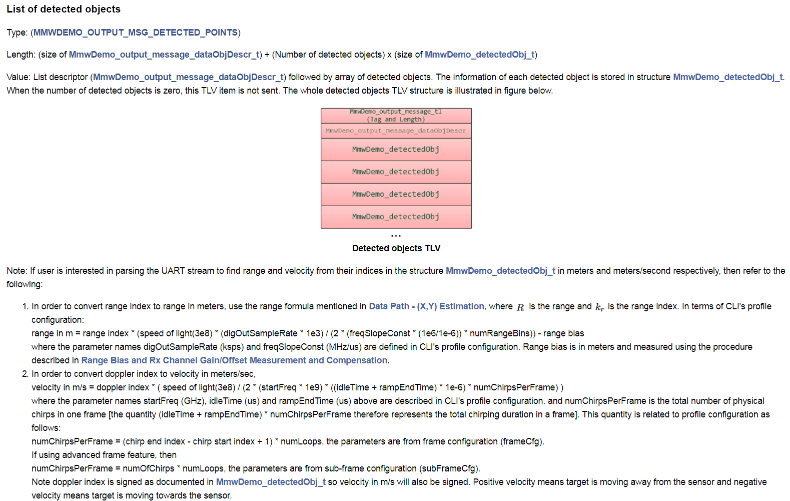

  • Because of repeated queries on the question you have raised here, we have decided to document this in the doxygen documentation of the next release in the section "Output information sent to host" (which contains all documentation about TLV formats of UART stream), but a preview below in the meantime will hopefully make it a little easier for you (and others), formulas use information from CLI configurations:

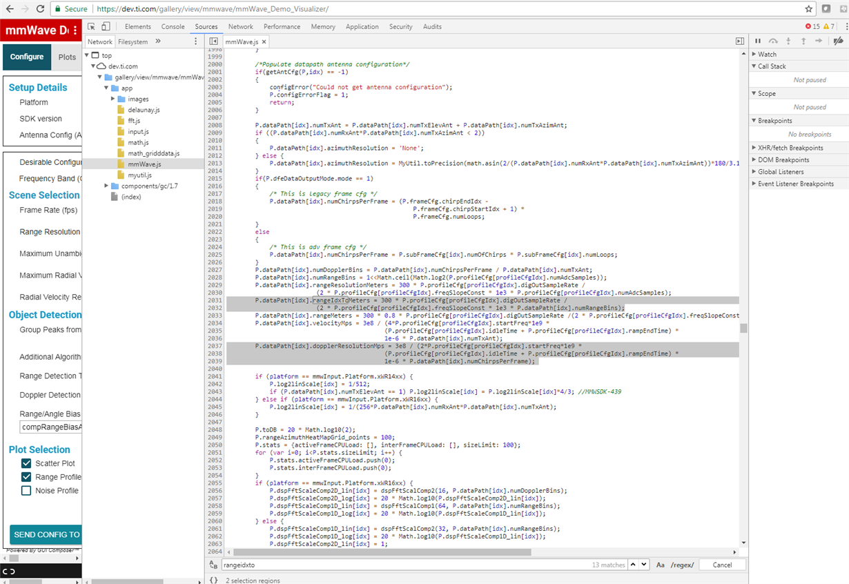

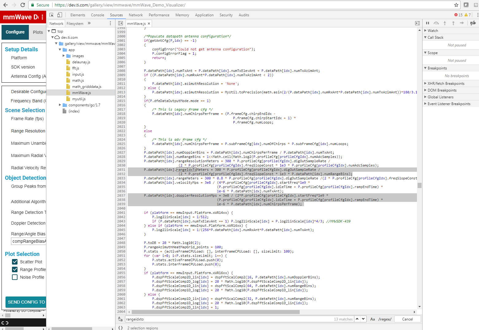

    You can also inspect the source code of the visualizer which gives the same information as above because visualizer displays in m and m/s. To see visualizer source code, follow instructions at
    A snapshot of the area of code that is related to his query is shown below (range index is multiplied with rangeIdxToMeters and doppler index is multiplied with dopplerResolutionMps):
