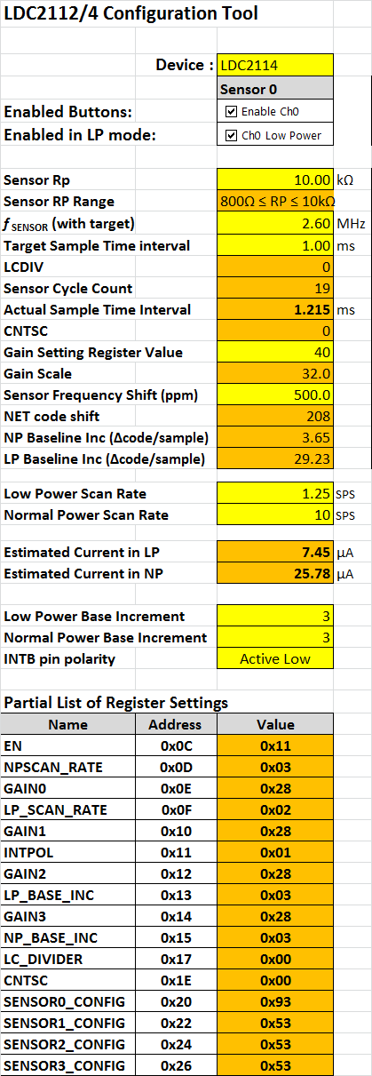

    You will likely need to adjust the SENSOR0_CONFIG, LC_DIVIDER, and CNTSC registers to be appropriate for your sensor.
    According to the LDCCOILEVM user guide, coil L has an inductance value of around 55µH. By default the LDC2114EVM has a sensor capacitor of 47pF and pin input capacitance of 17pF. The expected oscillation will be around 2.7MHz as a result. You can use the LDC2114_Config_Tool tab of our LDC tools spreadsheet ( www.ti.com/.../slyc137 ) to give you a good starting point:
    Note that we also offer the LDCTOUCHCOMCOILEVM ( www.ti.com/.../LDCTOUCHCOMCOILEVM ) which is specifically designed for the LDC2114 and includes the appropriate sensor capacitor selection and register settings in the user guide.
