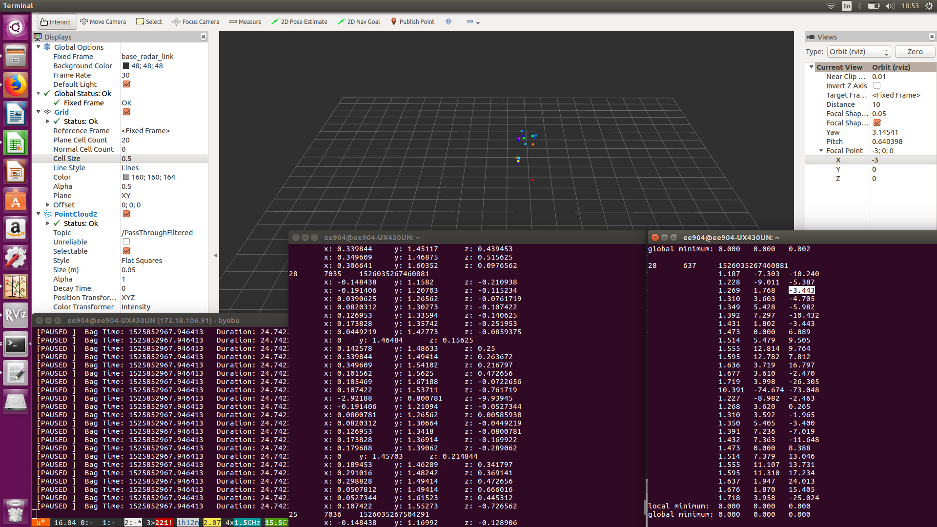

But why can I get so many measurement points (28)? In my understanding of the azimuth resolution, I would get only four points if the field of view of the antenna is 60 degrees. The resolution of elevation angle is similar.

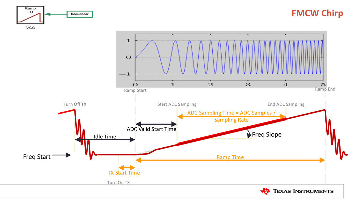

3. For the catkin_ws/src/ti_mmwave_rospkg/cfg/1443_3d.cfg file, I can not derive the above parameters (range resolution and max, velocity resolution and max) from the following configuration command. Here is my calculation process.
chirp duraing = idle time + ramp time = 7 + 57.14 = 64.14 us
range resolution = speed of light / (2 * bandwith) = speed of light / (2 * slope * chirp duraing) = 3*10^8 / (2 * (70*10^6) * 64.14) = 0.0334 m
range max = max IF bandwidth * speed of light / (2 * slope) = 5*10^6 * 3*10^8 / (2 * (70*10^12)) = 10.71 m
velocity max = wavelength / (4 * chirp duraing) = 3*10^8 / (77*10^9) / (4 * (64.14*10^-6)) = 15.18 m/s
velocity resolution = wavelength / (2 * frame time) = 3*10^8 / (77*10^9) / (2 * (33.333*10^-3)) = 0.0584 m/s
This completely does not match the above reference value (0.044 m, 9.01 m, 5.06 m/s, 0.64 m/s). Where am I wrong?
