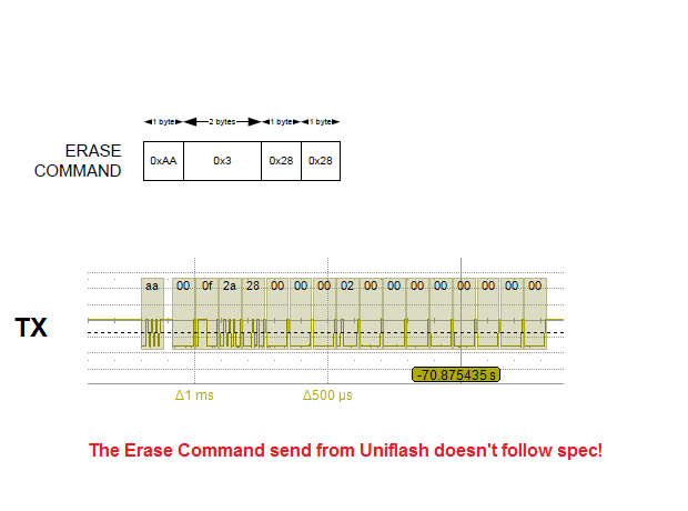

    I have done some reverse engineering on the communication between UniFlash and IWR1443 and it seems like the communication doesn’t really follow the flow and protocol according to SWRA561.

    The commands/responses for Get Status and Erase seems to differ from the specification.

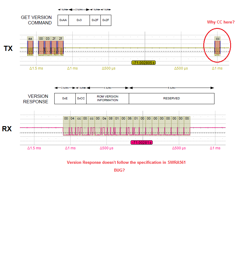

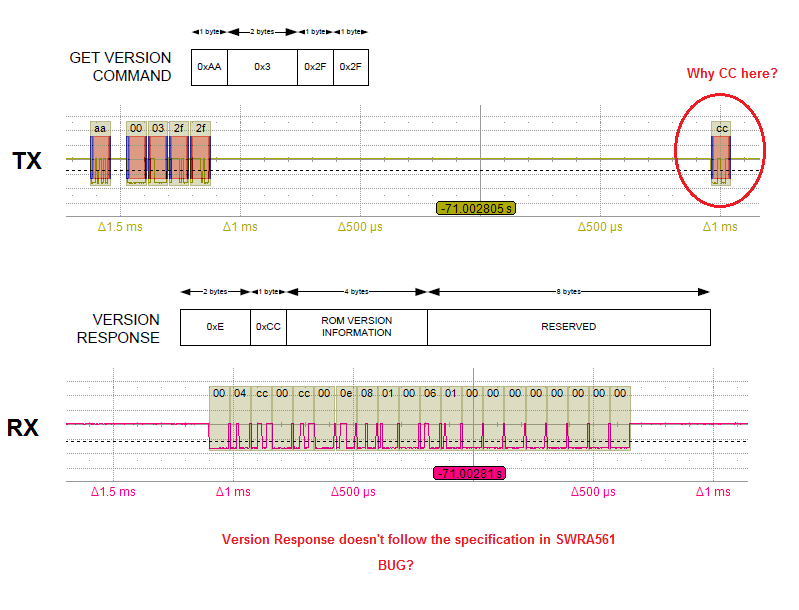

    8. Observed VERSION RESPONSE does not match the app note.
    [TI] In Figure 10 in the app note, the VERSION RESPONSE row has an incorrect checksum column. It should say “CHECKSUM”, not “0xCC”. Also, Uniflash is sending a single-byte ACK (0xCC) to messages from the device, however this is not required and is actually ignored by the bootloader.
    9. Observed ERASE command does not match the app note.
    [TI] Uniflash supports additional storage type and size fields for erasing the flash. However, the bootloader doesn’t interpret these fields and just erases the entire SFLASH. The host could implement as shown in the app note.

    I have just one follow up comment on item 8. The response according to my image has more discrepancies compared to the app report than the checksum. For example the response length (first two bytes) is 0x4 and should b 0xE. The actual response length is obviously longer than 4 bytes. To me it seems like the VERSION RESPONSE has been partly overwritten by an ACK RESPONSE, i.e the beginning of the response is an ACK RESPONSE and the end is the VERSION RESPONSE. Can you please check if this is a bug in the bootloader.

  • Haakan,
    The bootloader acknowledges the GET VERSION command by sending an ACK message to the host before sending the VERSION RESPONSE.

  • You are correct, the reponse to the GET VERSION COMMAND seems to be first a ACK RESPONSE and then the normal VERSION RESPONSE. Strange that some reponses have a ACK before the actual reponse. Not what I expected...
