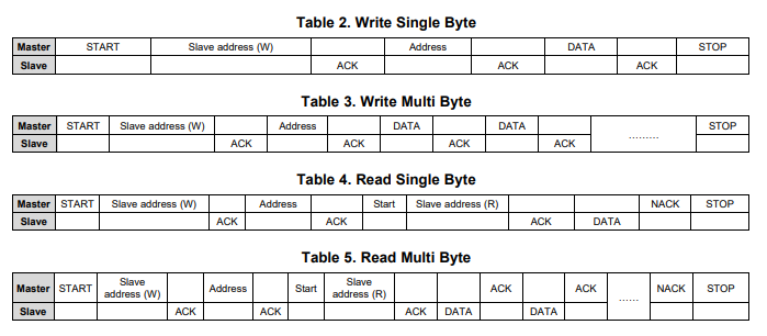

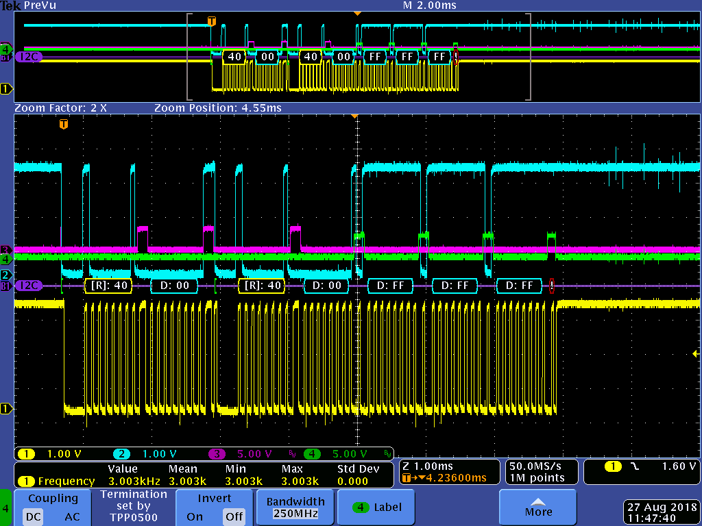

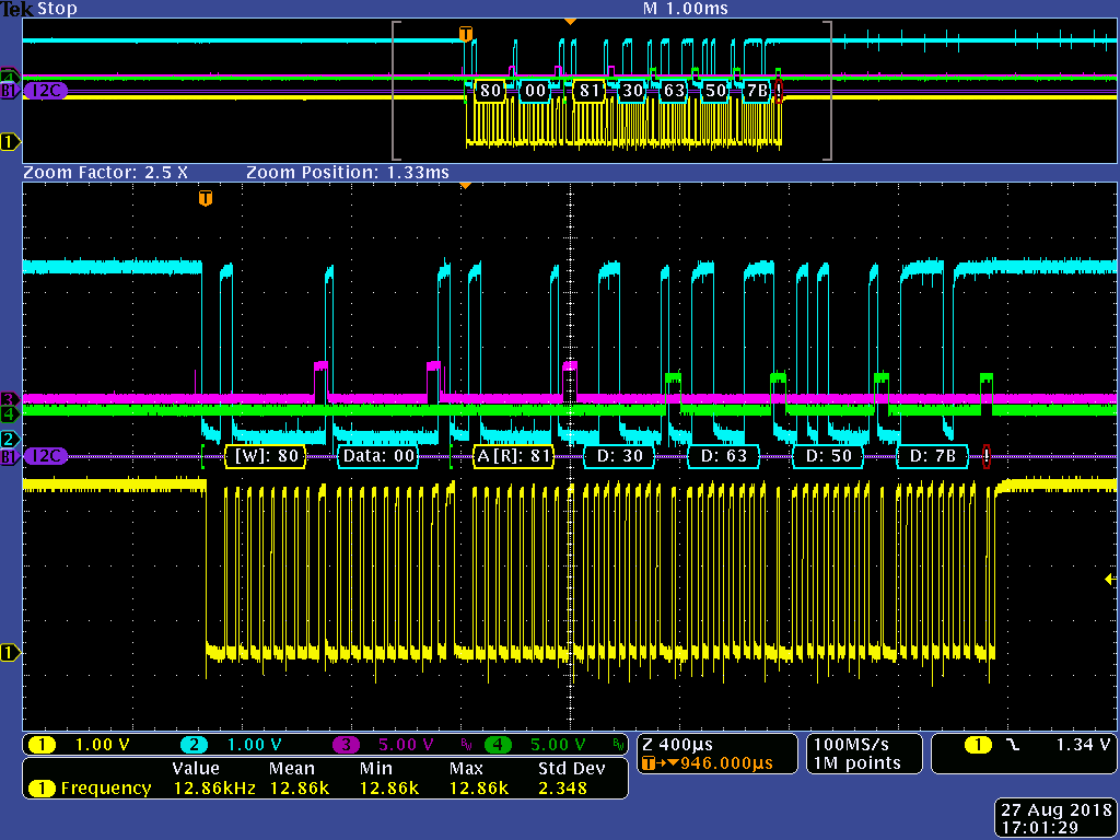

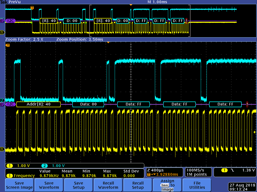

Problem -> Not able to get data out of HDC2010 via I2C, I2C not properly interfaced.
Initially HDC sort of gives out 0x00 for register 0x00, but then goes high. does not seem to respond.
Attached is the scope plots of an I2C communication between my micro and HDC2010 - suspecting any ACK issues?
I2C is bit banged on to 2 GPIO by controller.
Any hints why ?
