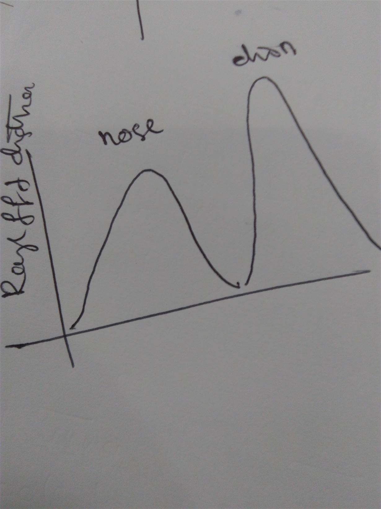

    Could you pls explain last part, what is the extent that I can separate the chin and nose distance using phase signal, if human face is stationary they I feel we will not have any phase change in the signal.
    with 60 GHz higher RF band  is it possible to satisfy my requirement of separating nose and chin distance?
    Basically tell me what I am suppose to do, if my radar want to detect nose and chin as separate object and should give distance separately?
    Referring to fig above Is it possible to find  distance R1 and R2 separately. take the width of projection is 2 cm. and flat portion extends to 6 cm comparable to nose and chin.
    I was going through tuto doc by Mr.Sandeep rao from TI and it was mentioned that, if 2 objects sep by 3.75cm and are at different distance wrt sensor the phase of reflected chirp would be different, if same principle is used for nose and chin, nose is projected front than chin so the distance between sensor and nose will produce reflected chirp with f1 and phase1 where as chin gives f2 nearly equal to f1 and phase2. With phase info can we process the signal to get range information?

    1."Related to range, velocity, and phase - there is a detection process where objects > detection conditions are active objects. You may need a method to detect the nose, lips, chin as separate objects, a point cloud can be tracked , the center of a point cloud can be subtracted from the center of another point cloud, and a distance can be computed. Object detection can be done on distance, velocity, and phase information"-
    What I am thinking is to, process signal reflected by nose and chin if possible to detect, since there will be projection of nose the reflected wave will have one phase and chin will have one phase by keeping dmin as 4 cm between nose and chin. And try to map this phase change with extra distance travelled.

    I want to get Range FFT as shown in the above figure.

    1) If the person is breathing  deflections in the nose area or cheeks  could be detected for doppler as well as position.

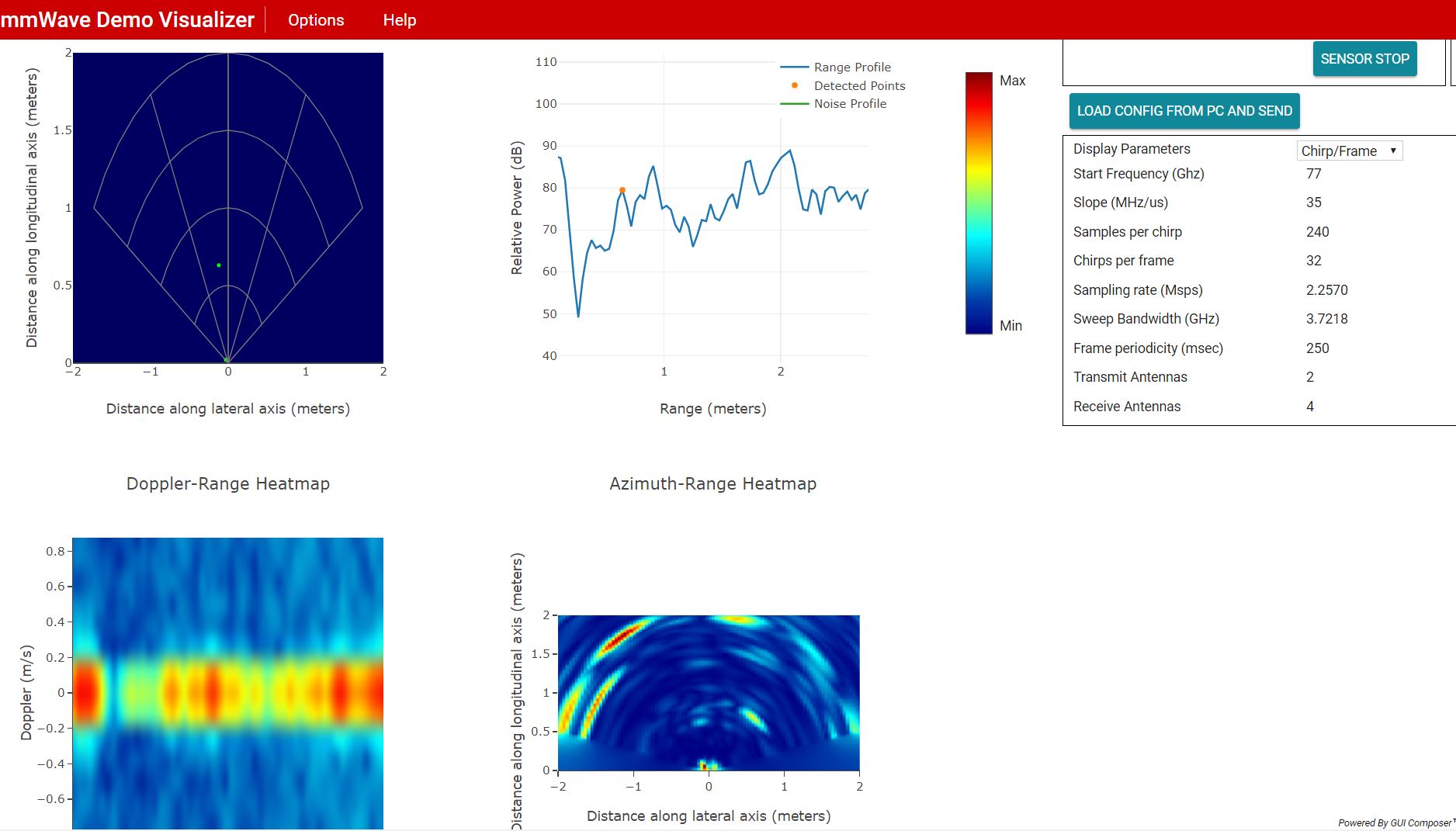

    4) If you put the mmwave sensor EVM on a tripod, and adjust if related to the target face, using the Best Range Resolution, you should be able to adjust the parameters (following swra553 - different chirp items) to get short range range and velocity information.
    I have used the 4fps, side and front view.   You can try this with other experiments.
    front view (mmwave selfie)
    side view
    example config file
    sidefront_1443.cfg
    Joe Quintal

    1. Is it possible to change the scale of plot, In above fig range plot is in meters, I want to use it in cm steps. So that I can see good differentiation between nose and cheeks.
    2.Could u pls try the same exp, with step changing to cm, I don't see the range value of nose in current range power plot, only I can see 4 points which are after 0.5m.

    1) Eventually the Radar chirp Frequency will establish the range resolution. In the mmwave Industrial Toolbox, there are Labs and Experiments that discuss zoom FFT concept for measuring < range resolution limit.
    2) A point cloud - is a set of parameters defining a detected point - " en.wikipedia.org/.../Point_cloud "
    3) your picture seems to be a front view, if you are trying to detect the image of a nose and chin for biometric purposes, you would store a normalized point cloud. You would normalize position, and have to have some method so the angle from the radar antenna to the sensed person is nearly the same. You could then compare a normalized repositioned average point cloud to a stored parameter set, and set a GPIO for red(not OK)/green(OK). In this concept this has an analogy to an optical scanner, looking for a matching pattern.

  • Hi Joe,
    What and all can be done with only IWR 1642 dsp processor ? Can I do those point cloud processing what you told earlier witout DCA1000?
    If in case I am getting the plot of range, where do I have the value for comparison?
    Let us say I have a signal reflected from face and I will get the range or angular plot as shown in your expt images. Where will I have the range value which will be displayed on plot?
    I would like to process the data in, inbuilt DSP itself to get zoomed FFT and range value which are of 4cm resolution, I should be able to get 2 range FFT peaks which are 4 cm apart when I set the mmwave to max resolution of chirp config. What I am telling can it be acheived without DCA1000? I mean only with IWR 1642 DSP and ARM?
    Plsase explain different points you have got in range and angluar plot of mmwave salfee? i see 2 very nearby objects is it 2 points on face or 2 different objects( Image is attached in last 2 post)
    Karthik S

    In your picture , face front view, you would need to reduce the Field of View with a lens. The min Range Resolution is based on the Chirp Bandwidth. When you have smaller than the Range Resolution, this has to use phase processing.
    I suggest you start with the Gesturing for Phase processing, and AWR Occupancy detection for point cloud.
    Joe Quintal
  •  Hi Joe,
    I agree with your point of Phase processing.
    I wil just tell my req in a line: In mmWave selfie, I want to measure a distance from sensor to nose tip. what I have to do in terms of processing.
    If I use point cloud and subtract the centres, I will get distance between nose and chin I need accurate distance between nose tip and sensor.
    I went through vital signal lab but could not identify the part of phase processing.
    Since FFT of signal reflected from phase would look like single peak as far as I understood and I am interested in the signal reflected from nose to sensor since I need shortest distance.If it is leg and from the tip of the finger. Please help me in this.
    I went thorough the 2 labs you mentiond. But could you pls help me which .C or .H file I have to look into for phase information?
    And which file should be need to be considered for modification in case of customization?
    It woulf be good if you could show which part of code I need to see, for comparison of range value for threshold and activating GPIO..when I studied doxygen doc all are explained wrt memory. So how exactly will I compare the values?
    regards
    Karthik
    Regards'Karthik

  • Hi Joe,
    where do I have the range value for comparison?
    regards
    Karthik
    There is no one mmwave software that includes phase processing , or object tracking on small features.
    You can download the people counting demos, and study the tracking with the IWR1642. After you have studied and worked with this,
    The profile command will need to be modified to mazimize to 5Mhz Ito get the highest range resolution, at a close distance.
    Specific signal processing for your application following the concept of point cloud, detecting objects and constructing a surface profile, should be asked with a new thread, so the proper application engineer for detection answers your questions,,
    REgards,
    Joe QUintal
