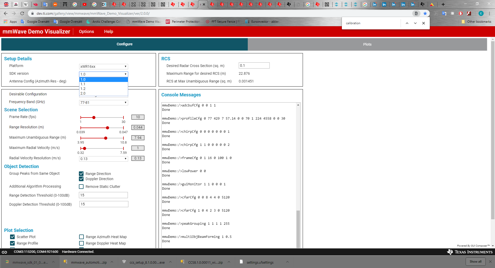

I am trying to via UniFlas down load new config file.
but it dos not work with SDK vertion 1.0
how to change this?
  • HI,
    I think there is some confusion. The snapshot provided is not from Uniflash, I think it is from the mmWave SDK demo visualizer.
    Unfortunately the snapshot is not clear enough to see the reading.

  •  Hi Cesar
    I bought the AWR1642Boost EVM in 24.04.2018 it says SDK 1.0 in mmWave SDK demo visualizer.
    But it seams I need a higher vertion to install other demo firmware via UniFlash.
    can i update the SDK vertion in the AWR1642Boost EVM
    Emil

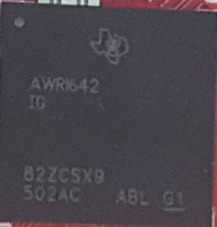

  • Hi
    Please check if the silicon has "502A" as shown in picture above.
    If it does this means you have an EVM with ES 2.0 Silicon.Then you need to download SDK 2.004 which is the latest release to support AWR1642 ES 2.0 silicon
    If it does not then, this means you have an EVM with ES1.0 silicon and you will need to download SDK 1.2, which is the latest SDK supported on AWR1642 ES1.0 silicon
    Thank you
