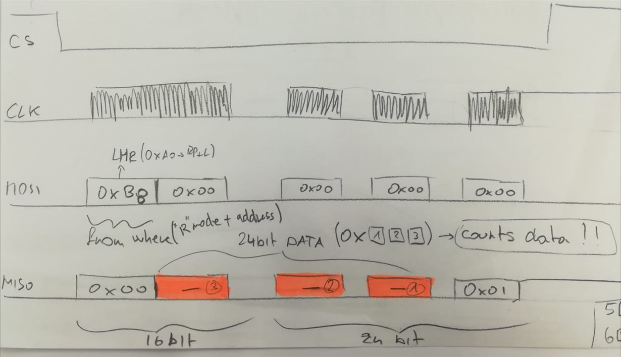

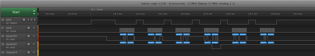

    I was able to read the SPI signals of the EVM LDC1101 module through a logic analyzer and tried to recreate the same protocol.
    That's right, if the first bit is at 0 it means that we are in WRITE mode. In fact, these first bytes in the screenshot I posted, represented the configuration of the LDC1101 chip. They need to be WRITE mode (In EVM, it's the same thing).
    After that, the data is read out. Here I don't understand if I have to expect the automatic response of the LDC1101 sensor or if I still have to send bytes but this time in READ mode.
    So, I should get or create a 5-byte data packet as follows in the image. In case I don't do anything, I don't get anything. In case I send packets with address (READ mode) on MOSI, I always get the MISO signal without information.

  • HI,
    I've just found a solution. The problem has been related to the SPI Mode. In my code the configuration was good but apparently wrong for the logic analyzer. So, I was not able to see something on MISO pin.
    Thank you for support me.
