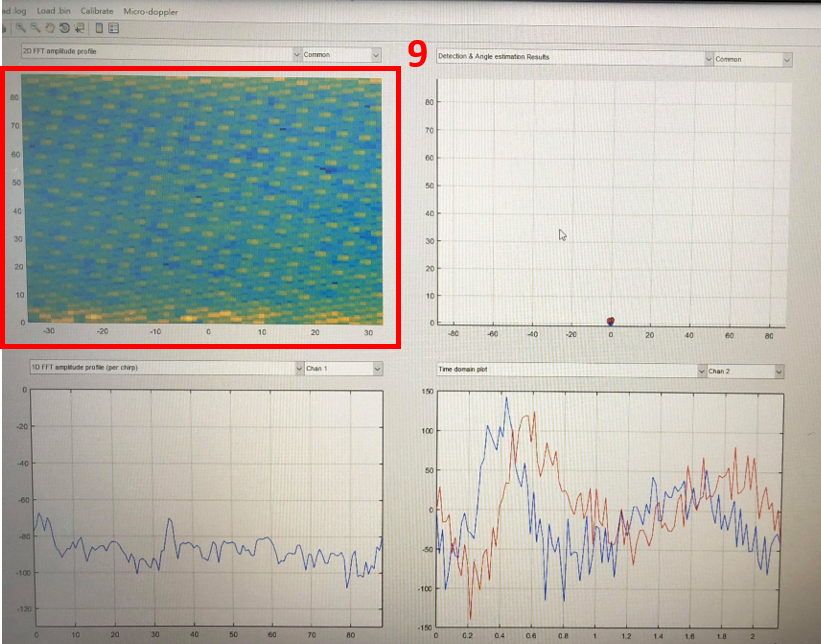

When I use the different chirp setup for the same waveform, I will get the different results.
The following is an instance of my two different experimental results.
1st method,
2nd method,
Please help me to solve this problem. Thank you.

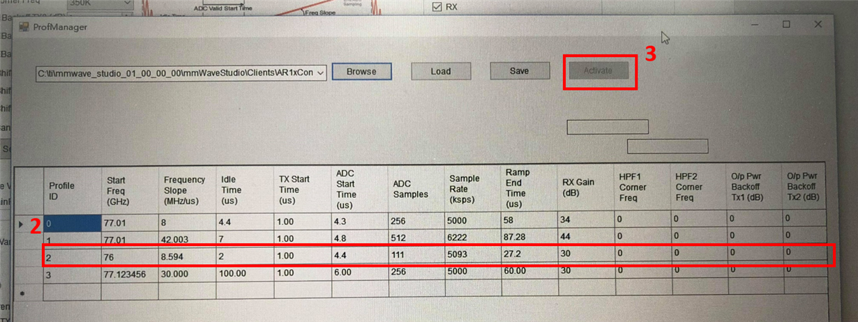

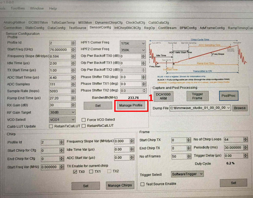

  • Hi Michelle,
    Thanks for your reply. I definitely used the mmwave sensor estimator to calculate the chirp parameter to fit my design.

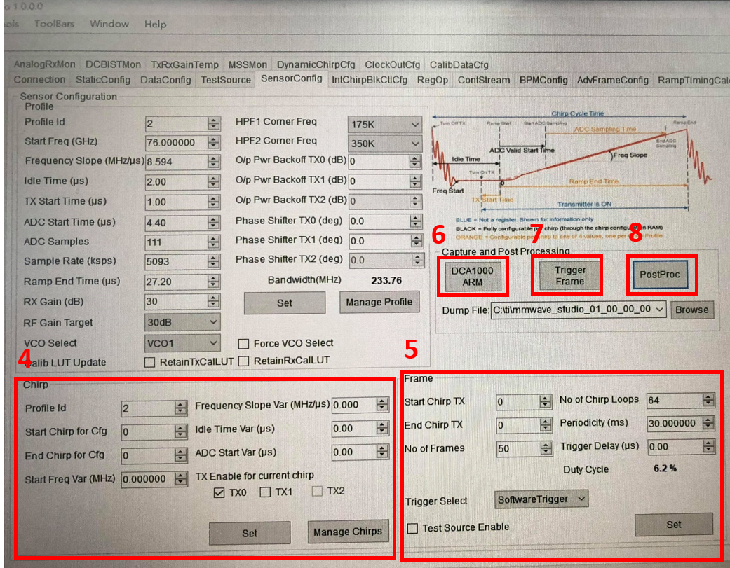

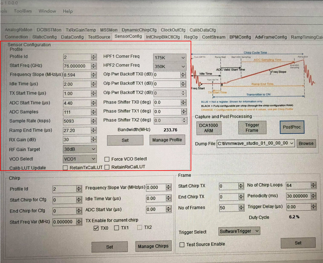

    In the 1st method, I selected the option "Manage Profile" directly, and fill the needed values to finish the setup of chirp parameter. Unfortunately, the 2-D FFT map seems no response with the moving target.
    On the other hand, in the 2nd method, I fill the values in the blocks of sensor configuration instead, and leave the "Manage Profile" blank. The result is totally different with 1st method, and the 2-D FFT map change as the target as I expected.
    Best regards.

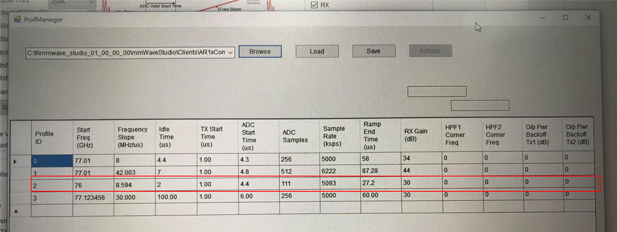

  • Jacki,
    I now understand what the issue is. I will need to run the test myself to check.
    In the meantime, here's some suggestions I would give if you haven't tried.
    1. Make sure in profile manager, you follow Edit> Save> Activate sequence
    2. Compare the output log of the two sequences to see what is different

  • Hi Michelle,
    Thanks for your suggestion and look forward to your experimental results.
    By the way, I used AWR1642EVM integrated with DCA1000.
    As your suggestion, I already followed Edit> Save> Activate sequence.
    The output log showed no difference between these two different method.

  • Jacki,
    The issue is reported but it won't be fixed until next mmwave studio release.
    The problem is the profile parameters passed to matlab for post-processing is not handled correctly. One way to by-pass it is that you can set profile 3 same as profile 2, then you will see the same result.
