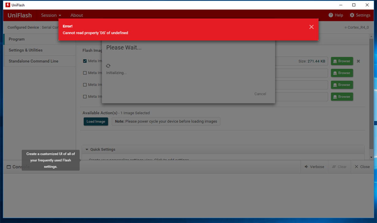

Request to please assist in resolving attached error as i am not able to contact the EVM.
Yes , Mr Jitendra Gupta, I selected the AWR1642Boost and updated the port but still it is showing the same fault.
Hi Sandeep,
Can you try flashing exercise from other PC? We have seen sometimes PC is the problem.
And if you are installing offline Uniflash then install as Admin.
Make sure you have set SOP2 and SOP0 jumpers on EVM and then power cycle before initiating uniflash.
