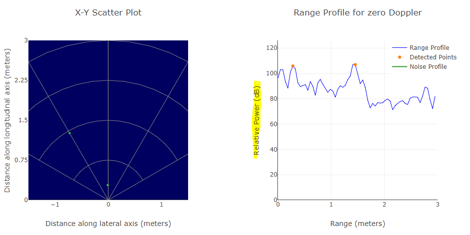

I get message out data (peakVal) and how to transfer (use math) to relative power (dB)?
e.g. peakVal = 6000 and form mmWave Demo Visualizer check, relative power is about 110(dB)

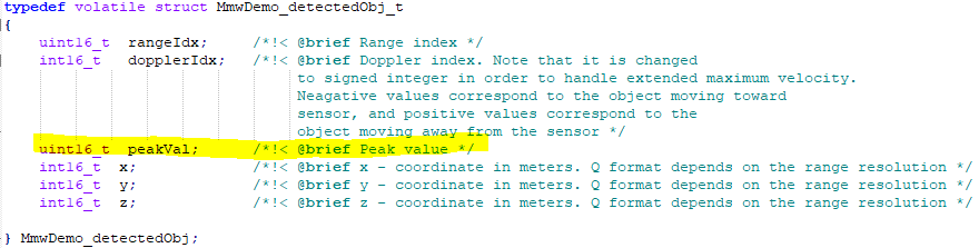

The Range Profile plot shows the 1D FFT output for zero Doppler, which is sent in a separate message in the UART data stream. This plot does not use peakVal which is part of the detected object list which is sent separately and contains only the objects which pass detection after CFAR processing (Range and Doppler)
Please look at the mmw demo doxygen documentation under C:\ti\mmwave_sdk_02_01_00_04\packages\ti\demo\xwr16xx\mmw\docs\doxygen\html\index.html and search for MMWDEMO_OUTPUT_MSG_RANGE_PROFILE.

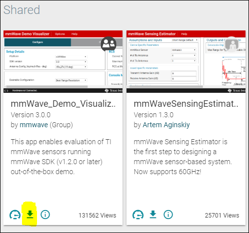

To understand the processing, you can download the Visualizer source code from dev.ti.com/gallery (shown below)

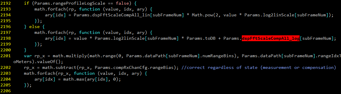

Look under the file install_image_mmWave_Demo_Visualizer\mmWave_Demo_Visualizer\app\mmWave.js under function processRangeNoiseProfile as shown below
The various factors used in the above equation (Params.log2linScale. Params.toDB, Params.dspFftScaleCompAll_Log) are calculated in the file install_image_mmWave_Demo_Visualizer\mmWave_Demo_Visualizer\app\input_validation.js as shown below:
