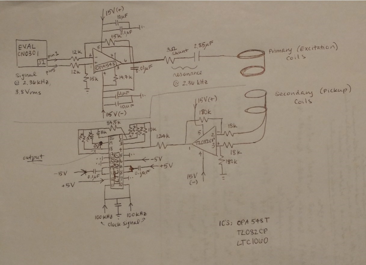

  • Hello Michelle,
      Would you please provide a schematic of the electrical components of this design?  Please include all power sources, electrical connections to the coils, etc.  Reading your description I'm not understanding what electronic circuitry is involved and specifically what ICs are in use.  Once we see the circuitry involved, we will better be able to assist.
    Thank you!
    ~Leonard
  • Hi Leonard, above is the schematic I drew including all the ICs, power supplies, inputs, and passive components.  Please let me know if I can elaborate on anything else.
    Thank you so much for taking the time to help.
    Michelle
  • Hi Michelle,
    I'm not an expert on LVDTs, but I'll try to help you out and see if the TL082 is working as desired.

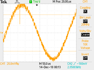

    Can you provide some oscilloscope shots (or other empirical data) of the following:
    * Input signals for the TL082 when the ball is left, right, neutral (to compare against each other)
    * Output signals for the TL082 when the ball is left, right, neutral
    It would also be useful to see if the signal that is driving the primary coil stays the same as the ball is moved into the various positions.
    Paul
  • Hi Paul,
    Thank you so much for offering your help.  I've attached all the signals from the scope that you requested.  The signal driving the primary coil does stay the same when I move the ball around, so at least that works!
    Please let me know what you think.
    Thanks again,
    Michelle
     in, left   in, neutral   in, right
    out, left   out, neutral   out, right
  • Hi Michelle,
    At least on a basic level, the op-amp appears to be doing it's job of amplifying the signals by 10 - the inputs under various conditions produce the expected outputs.
    Have you double checked your physical coil connections? Are the amplifier inputs connected to the secondaries? I thought this article had some helpful diagrams: www.ni.com/.../
    I don't think there are any op-amp properties that would directly cause what you are seeing and if the drive signal into the primary is constant and correct, that tells me that the drive circuit is probably functioning as expected.
