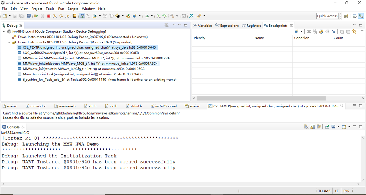

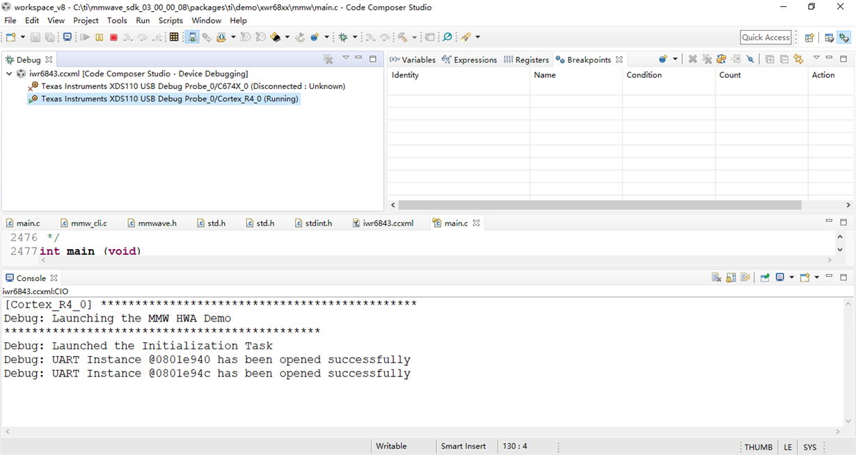

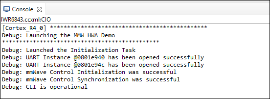

    Sorry to hear about the problem on your setup. In order for us to debug the issue, could you please follow the instructions below and provide a CCS stack trace for the OOB demo at initialization?
    1. Follow the instructions provided in section 3.2.2: CCS development mode, to run the OOB demo in CCS mode. Please use the pre-compiled binary  Cortex R4F binary under C:\ti\mmwave_sdk_03_00_00_08\packages\ti\demo\xwr68xx\mmw\xwr68xx_mmw_demo_mss.xer4f. Note that the 68xx SD OOB demo does not require the DSP so you can leave the DSP unconnected in CCS.
    You should see output similar to the following in the CCS console:
    2. Halt the R4F core using the pause button in the CCS toolbar and take a snapshot of the function call trace as shown below. Please provide the call trace snapshot from your EVM for the failure condition.

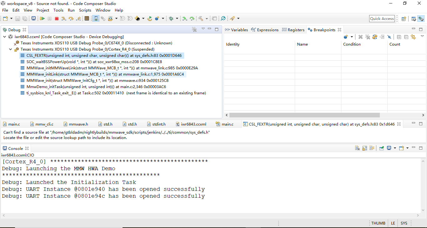

    Here are our snapshots.
