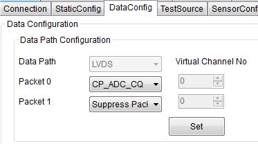

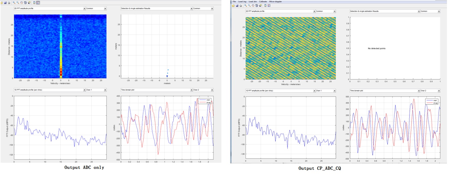

  • Jitendra,
    I am trying to test the ADC data +CQ with AWR1642 EVM+DCA1000EVM+mmWave Studio. But with below DataConfig setting in mmWave studio, the result of post process is not correct. Would you pls kindly advise what I missed?
    Below comparison tests have same config, except the Packet 0 setting in Data Path configuration. Left side is configured as ADC_ONLY and right is as above (CP_ADC_CQ).

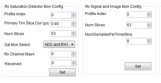

  • Hi Chris,
    You will also need to enable the appropriate monitors (RX Saturation Detector Mon Config and RX Signal and Image Mon Config groups) in the Analog RX Mon Tab in mmWave Studio.
    The tab you show is only for the data path - if the corresponding monitors are not enabled, the returned data will be incorrect.
    Anand
  • Anand,
    I tried to enable above monitor config you mentioned after framecfg set. Then I did capture and post processing. But the result is still not correct (similar as I shared before). Would you pls kindly help again?

  • Hi Chris,
    The known issue I mentioned appears to be a post-processing issue with the tool in mmWave Studio - the raw ADC data should still be okay.
    Is it possible for you to recreate this issue and upload the raw data files for the two cases here? We can check it offline and get back to you.

  • Anand,
    Would you pls kindly help to compare attached two outputs on angle estimation?
    https://e2e.ti.com/cfs-file/__key/communityserver-discussions-components-files/1023/adc_5F00_data.7z

  • Hi Chris,
    I checked the data now. This is due to an issue in the post-processing DLL released with mmWave Studio 2.0.0.2. It will be fixed in the next release.
    If you want to check this yourself, you can use the DLL included in the attachment. Please copy it to the following location:
    C:\ti\mmwave_studio_02_00_00_02\mmWaveStudio\Clients\AR1xController
    Anand
    https://e2e.ti.com/cfs-file/__key/communityserver-discussions-components-files/1023/CPCQ_5F00_Fix_5F00_MatlabPostProc.7z
  • Hi Chris,
    Can you confirm that this issue is resolved with the updated DLL?
    Anand
  • Anand,
    Thanks. The patch solves the mmWave studio issue with CQ data.
    I tried and can't reproduce customer's issue. I have asked customer to try to see if the issue can be reproduced with fixed corner reflector at their own board/own capture card.
