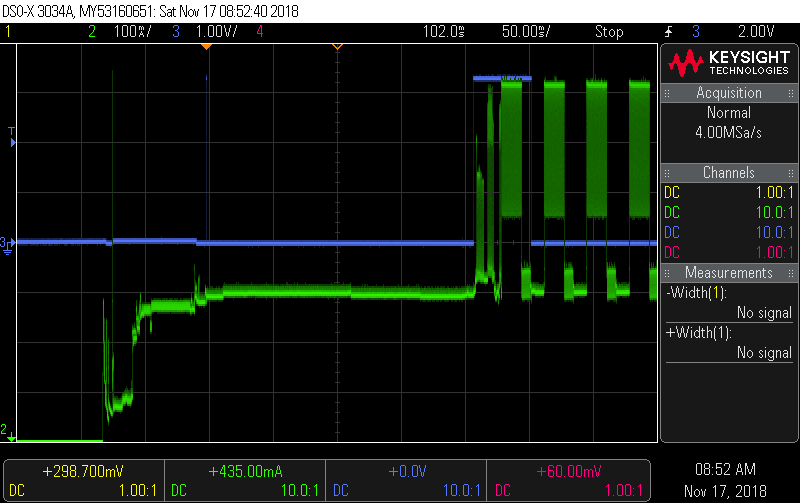

    Can you check your power supply? You should be using 5V 3A. It is possible for the OOB demo to run with lower power draw than the people counting demo. In this case you might see that the OOB demo works, while the People Counting demo does not work.
    Justin

    we use a quite precise laboratory power supply with 0-30V range, putting out 3A at maximum. According to the power supply, the board draws at 5.0 Volts 0.51 amps when both images of the pplcounting demo are running in the debug mode. When I power cycle the board, the current is @5.0V 0.45 amps to 0.48 amps in idle.
    The OOB demo still works, drawing 0.52 amps at 5.0V.

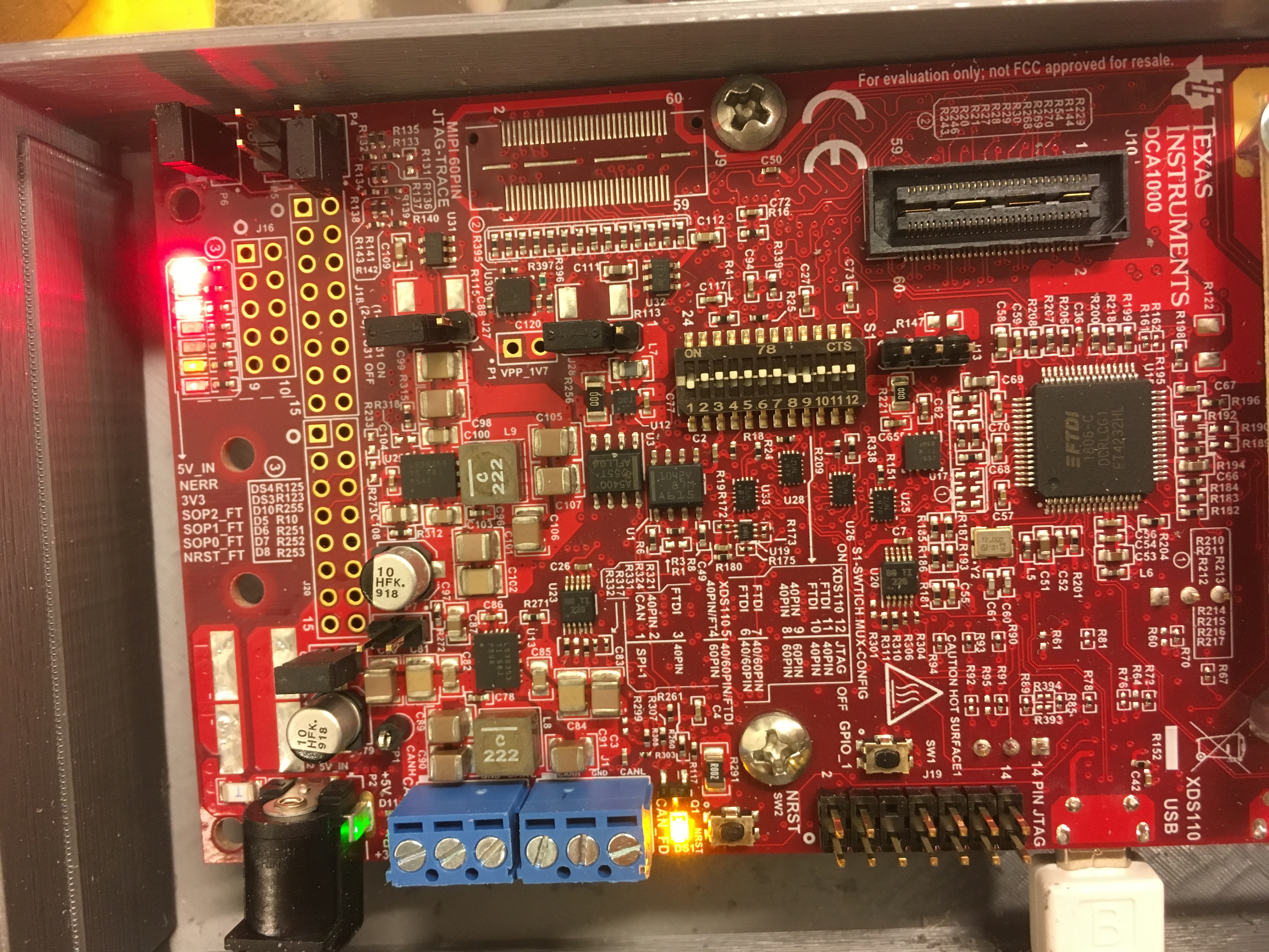

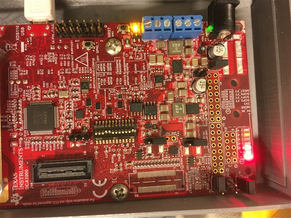

    now the story is getting really weird. To make sure that the power supply isn't the issue, we tried another one. On this supply, I wasn't able to start the DSS in the debugger at all, as the Code Composer studio was complaining about the processor being held in a reset state. The MSS started all right. I thought that this might be a problem with the current supply, although I got similar readings (about 0.5 amps at 5 volts) as before on this power supply too.
    I got back to the original power supply and flashed the OOB demo again. It froze after running for a minute or so. This was behavior I had never encountered before. I reflashed the board and noticed that the board had started to make a faint knocking noise. Now, for the second time the OOB demo started to run as expected and did not freeze, so I flashed the pplcount demo. Now it worked too. The GUI gets to the second view with the people counter and the point cloud visualization. The power supply now gives about 0.7 amps while the software is running and I can get presumably right looking results on the GUI. The board still makes the same faint noise.
    Absolutely no software changes were made during this, except the flashing of the board with different binaries (OOB demo and the debug firmware), which I have done numerous times before this. Can it be that there has been some small electrical problem on the board that now got (at least temporarily) fixed? A cold joint perhaps?
    Marko

    First I want to address the knocking sound - our EVMs will make a fainting beeping sound when actively chirping - could this be the noise you are hearing?
    As for the power supply, what is the current limit you have set on the supplies you were using? Typically, current draw looks something like this for a device running People Counting:
    So you can see that peak current will be about 750 mA.  Please check the first power supply to ensure that you were not limiting the current.

    Both power supplies are rated up to three amps, hi quality laboratory workbench power supplies. 750 mA consumption is about the right now. The ammeter on the original power supply shows now 0.7 amps during operation. Before this sound appeared, both power supplies showed a bit over half an ampere.

    To confirm, both demos are working now. This happened after the OOB demo failed. You then re-flashed the board with OOB, which worked, and People Counting, which worked. You have made no changes to the physical setup, or the software you used to flash the device.
    Justin
  • Hi Justin,
    yes, you are correct. So, to summarize:
    First, only thing that was working was the OOB demo. Pplcounting was still not working due communication errors. After that, I tried the other power, and with that one, either of the demos did not work. Then I returned back to my own workbench, and tried both demos, and they both worked. All the time, the same computer was in use and, naturally, the same software. The only physical change was detaching the device in order to carry it to the other workbench and back.
    Marko
