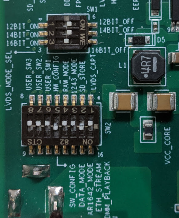

Here is how the pins are configured:

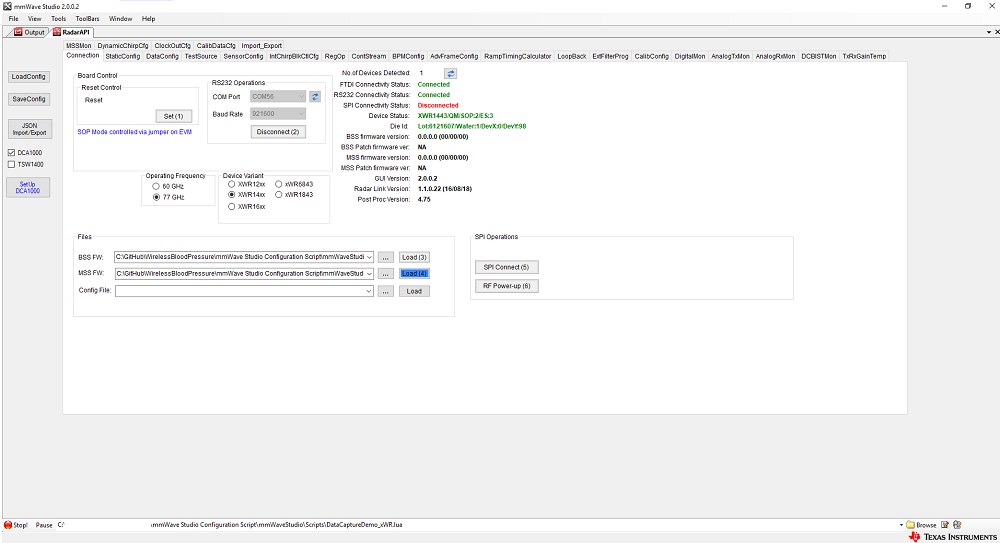

Here is a screenshot of mmWave Studio 2.0.0.2
This is a brand new board and I'm just trying to run the demo so I'm confused as to what's going wrong.
  • Salah,
    Please verify some settings:
    DCA1000:
    1. SW1
      1. POSITION
        SW1.1 ON
        SW1.2 ON
        SW1.3 OFF
    2. SW2
    1. POSITION NAME
      SW2.8 OFF USER_SW3
      SW2.7 OFF USER_SW2
      SW2.6 OFF USER_SW1
      SW2.5 ON SW_CONFIG
      SW2.4 OFF RAW_MODE
      SW2.3 OFF 1213_MODE
      SW2.2 ON ETH_STREAM
      SW2.1 OFF LVDS CAPTURE
    Hope this helps
    Alex
  • That didn't resolve my issue and I don't think the problem is with the DCA1000EVM board because it was working with a previous IWR1443BOOST card I had.
    Also, why would SW2.6 bet set to pin 6? Should it be set to pin 11 and use the default configuration instead of reading from the EEPROM?
  • Salah,
    WS2.6 makes no difference in your case, sorry for the confusion.
    This is to load settings from EEPROM which you can change IP address, mac, and other.
    Are the SOP pins on the EVM set for DCA?
    SOP0 and SOP1 closed, SOP2 open
    Alex

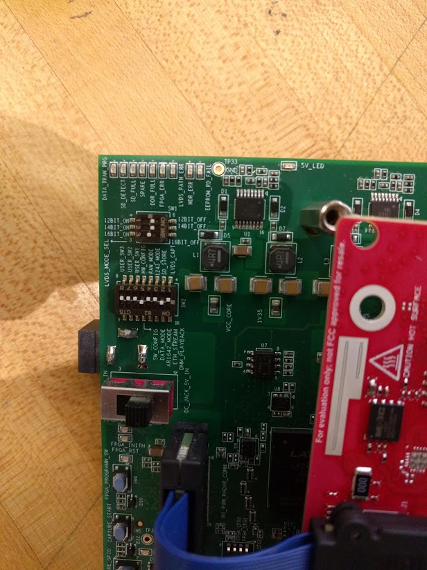

  • I've added a picture to show how the pins are configured on the DCA1000EVM board.
    EDIT: I've noticed that the new board is Rev B which has an added switch for choosing between SPI and CAN. It's currenlty set to SPI. I'm not sure if this is relevant but the board is slightly different.

  • Salah,
    Looking at the screenshot, looks like the firmware is the wrong one.
    Can you do the initial steps manually?
    Firmware location C:\ti\mmwave_studio_02_00_00_02\rf_eval_firmware
    BSS = radarss folder
    MSS = masterss folder
    1. Set(1)
    2. select COM port and speed, then click Connect(2)
    3. select BSS Firmware using "..." (3 dots) and load(3)
      1. BSS firmware version should have an non-zero value
    4. select MSS Firmware using "..." (3 dots) and load(4)
      1. MSS firmware version should have an non-zero value
    5. SPI Connect(5)
    6. RF Powe-up(6)
    Try this and let me know if it works

    [11:06:34]  [RadarAPI]: ar1.DownloadBSSFw("C:\\ti\\mmwave_studio_02_00_00_02\\rf_eval_firmware\\radarss\\xwr12xx_xwr14xx_radarss.bin")
    [11:06:34]  [RadarAPI]: Downloading BSS Patch RPRC Binary..
    [11:06:36]  [RadarAPI]: ar1.GetBSSFwVersion()
    [11:06:36]  [RadarAPI]: BSSFwVersion:(02.00.00.01 (05/10/17))
    [11:06:37]  [RadarAPI]: ar1.GetBSSPatchFwVersion()
    [11:06:37]  [RadarAPI]: BSSPatchFwVersion:(01.02.00.03 (24/10/18))
    [11:06:42]  [RadarAPI]: ar1.DownloadMSSFw("C:\\ti\\mmwave_studio_02_00_00_02\\rf_eval_firmware\\masterss\\xwr12xx_xwr14xx_masterss.bin")
    [11:06:43]  [RadarAPI]: Downloading MSS RPRC Binary..
    [11:07:39]  [RadarAPI]: ar1.PowerOn(0, 1000, 0, 0)
    [11:07:39]  Status: Failed, Error Type: RESP TIMEOUT
    [11:07:49]  [RadarAPI]: ar1.RfEnable()
    [11:07:49]  Status: Failed, Error Type: INVALID INPUT
    [11:07:50]  [RadarAPI]: ar1.GetBSSFwVersion()
    [11:07:50]  [RadarAPI]: BSSFwVersion:(00.00.00.00 (00/00/00))
    [11:07:50]  [RadarAPI]: Warning: BSS firmware version Mismatch!
    Again, the issue seems to occure here:
    I'm not sure what changed from Rev. A to Rev. B but for some reason the powering on just doesn't work the same way.
