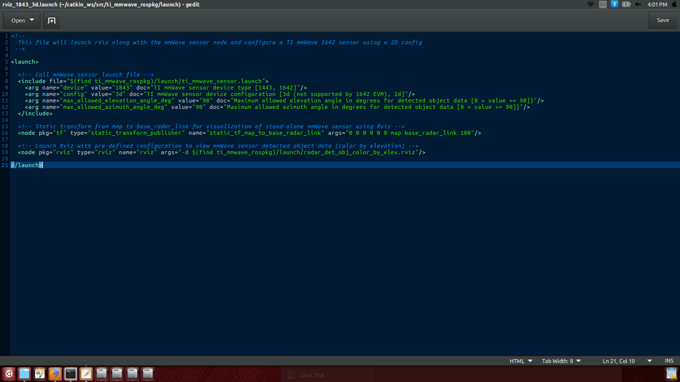

I'm able to view the 2d point cloud in ROS using AWR1843 EVM by creating an another launch file as shown below:
But to view a 3D point cloud when I create a configuration file using demo visualizer using 3tx antennas, the cfg file gets uploaded on the evm successfully but nothing is coming on the rviz window.
I want to see the 3d point cloud.
The .cfg file that is going on to the evm is the one show below:
