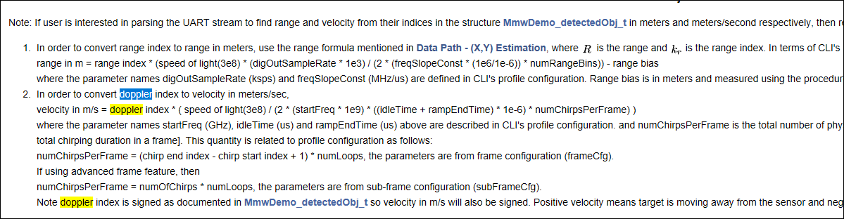

I am trying to convert the doppler bin to velocity after collecting the doppler bin index via UART. After reading this post:  I expected the range of doppler values to vary from 0 to 15 (given I have 16 chirps per frame). However, I received some doppler indeces in the range 65528-65535. I presume these are the negative indeces, but I am unsure whether 65528 is the maximum negative velocity or whether 65535 is the maximum negative velocity. 65528 seems more frequent from my observations, so I presume this is the lowest negative velocity and 65535 is the maximum negative velocity? Could you please confirm

    The Doppler Index to Velocity conversion is described in the mmw demo doxygen documentation at:
    C:/ti/mmwave_sdk_02_01_00_04/packages/ti/demo/xwr16xx/mmw/docs/doxygen/html/index.html as shown below:
    This means that a velocity index of 9 would be sent out as 9-16 = -7 and an index of 10 would be sent out as 10-16 = -6. So 65535 which represents -7 is a larger velocity than 65528 which is the lowest negative velocity.
