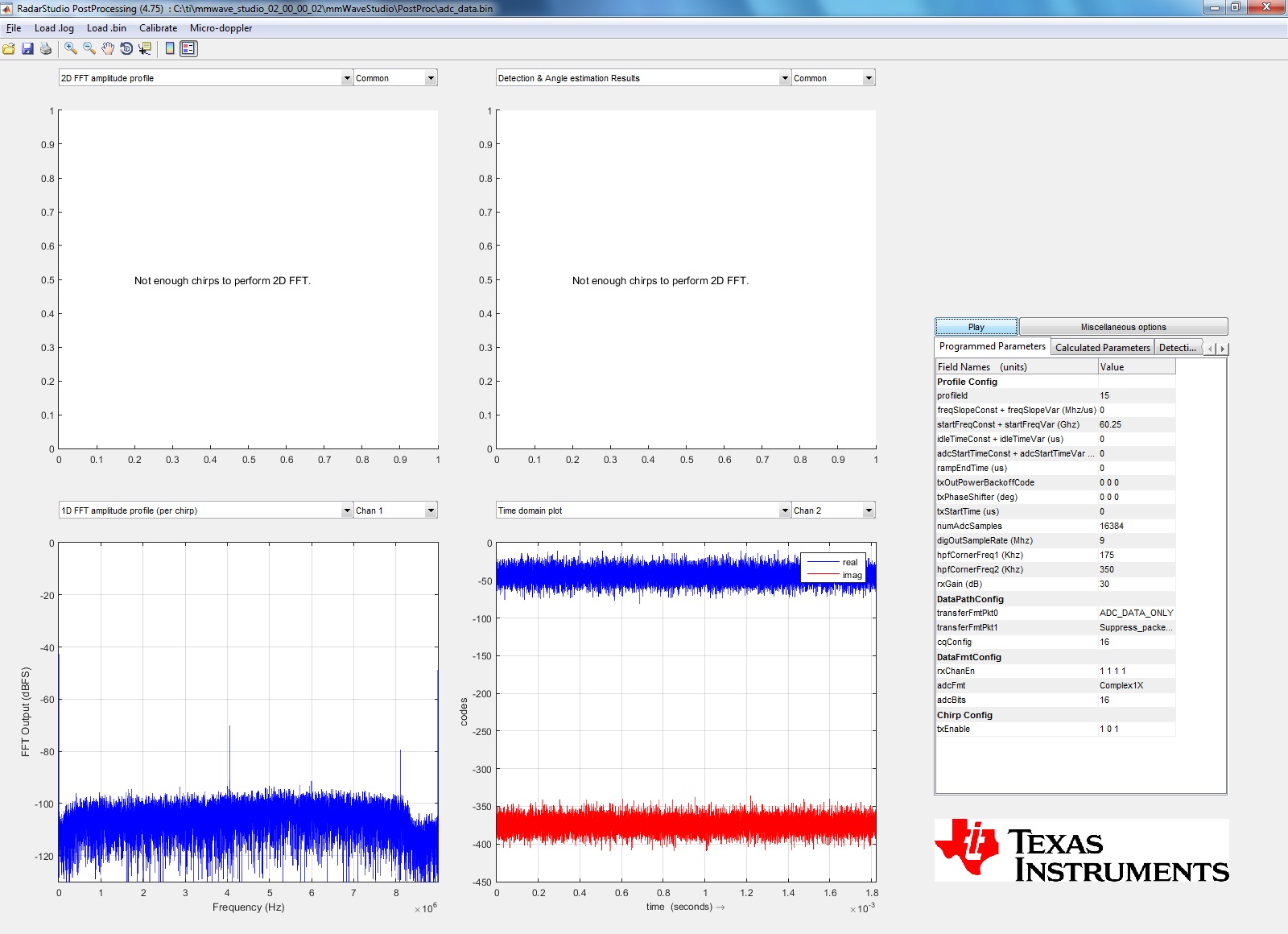

Hi:
I'm now able to get mmWave Studio 2.0.0.2 to work with "IWR6843ISK+MMWAVEICBOOST". I am also able to view the post-proc data after frames of data has been captured to disk.
However, I am running into the following problem when I want to be in Continuous Streaming mode: first I hit all the default set button on tab "Connection", "StaticConfig", "DataConfig", "SensorConfig", then I follow the steps on tab "Contstream" :
1) Set the StreamConfig : Set(1)
2) StreamEnable : Enable (2)
3) Basic configuration for analyses : Set (3)
4) Capture (4)
5) Display (5)
I get an error as in the following picture. Could you help? Thanks.

  • Alex:
    Any update on this issue? If you need further information, please let me know.
    Thanks.
    Ziyou

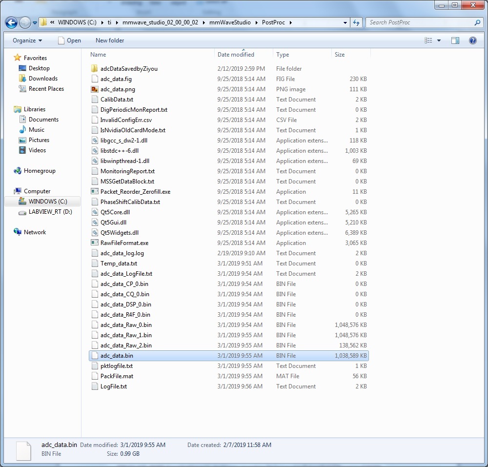

  • Ziyou,
    The log does not show the DCA1000 being set up, are you setting it up at all?
    Please look over this video LINK and confirm that you are able to capture data.
    Alex
  • Alex:
    FYI, I am and was able to capture data under tab "SensorConfig" and see the PostProc result in the Matlab window. I've re-done this and had the following log. I have made sure that I had the DCA1000 being set up.
    My current issue is under the "ContStream" tab:
    4) Capture (4)
    5) Display (5)
    I get an error, meaning the real-time display of the captured data (or real-time processed results) can not be launched. Please see the last section of the log below, as well.
    Thanks again.
    Ziyou

  • Alex:
    I've followed your instructions, 4.1) press "Stop Capture" after around 20 seconds and observed the following:
    1. After clicking the "Display" button, I did not get an error, instead I got the following GUI. The GUI gives me an impression that it has loaded the file "C:\ti\.......\adc_data.bin" for post processing.
    2. The saved file "C:\ti\.......\adc_data.bin" is a large file ( > 1.0G bytes in size). Yet when I click on the "Play" button, nothing is played in a frame-by-frame fashion. See a screen shot below.
    3. I then clicked on "Capture" and then "Display" ( without pressing "Stop Capture"), I got the same error message as last time.
    The log file content is copied-and-pasted below.
    So my questions are:
    1. Why does the "Display" button only work after the "Stop Capture" is pressed?
    2. Can the "Display" show processed results as the data is continuously streamed? As it currently stands, it only shows some post-processing results only after the data is saved to disk.
    3. Is there a way to show  processed results as the data is streamed in?
    Thanks.
    Ziyou

    [09:52:13]  [RadarAPI]: ar1.DownloadBSSFw("C:\\ti\\mmwave_studio_02_00_00_02\\rf_eval_firmware\\radarss\\xwr68xx_radarss.bin")
    [09:52:14]  [RadarAPI]: Downloading BSS ROM RPRC Binary..
    [09:52:20]  [RadarAPI]: ar1.GetBSSFwVersion()
    [09:52:20]  [RadarAPI]: BSSFwVersion:(06.00.05.00 (01/08/18))
    [09:52:22]  [RadarAPI]: ar1.DownloadMSSFw("C:\\ti\\mmwave_studio_02_00_00_02\\rf_eval_firmware\\masterss\\xwr68xx_masterss.bin")
    [09:52:23]  [RadarAPI]: Downloading MSS RPRC Binary..
    [09:52:27]  [RadarAPI]: ar1.PowerOn(0, 1000, 0, 0)
    [09:52:27]  [RadarAPI]: Status: Passed
    [09:52:27]  MSS power up done async event received!
    [09:52:28]  [RadarAPI]: ar1.RfEnable()
    [09:52:28]  BSS power up done async event received!
    [09:52:28]  [RadarAPI]: Status: Passed
    [09:52:29]  [RadarAPI]: ar1.GetBSSFwVersion()
    [09:52:29]  [RadarAPI]: BSSFwVersion:(06.00.05.00 (01/08/18))
    [09:52:38]  [RadarAPI]: ar1.ChanNAdcConfig(1, 0, 1, 1, 1, 1, 1, 2, 1, 0)
    [09:52:38]  [RadarAPI]: Status: Passed
    [09:52:40]  [RadarAPI]: ar1.LPModConfig(0, 0)
    [09:52:40]  [RadarAPI]: Status: Passed
    [09:52:41]  [RadarAPI]: ar1.RfInit()
    [09:52:41]  RF Init async event received!
    [09:52:41]  [RadarAPI]: Status: Passed
    [09:52:41]  [RadarAPI]: Time stamp, Temperture: 12688,39; APLL Status, Update: 1, 0; SynthVCO1 Status, Update: 1, 1; SynthVCO2 Status, Update: 1, 1; LODist Status, Update: 1, 1; RxADCDC Status, Update: 0, 0; HPFcutoff Status, Update: 0, 0; LPFcutoff Status, Update: 0, 0; PeakDetector Status, Update: 0, 0; TxPower Status, Update: 0, 0; RxGain Status, Update: 0, 0; TxPhase Status, Update: 0, 0; RxIQMM Status, Update: 0, 0;
    [09:52:46]  [RadarAPI]: ar1.DataPathConfig(513, 1216644097, 0)
    [09:52:46]  [RadarAPI]: Status: Passed
    [09:52:47]  [RadarAPI]: ar1.LvdsClkConfig(1, 1)
    [09:52:47]  [RadarAPI]: Status: Passed
    [09:52:48]  [RadarAPI]: ar1.LVDSLaneConfig(0, 1, 1, 0, 0, 1, 0, 0)
    [09:52:48]  [RadarAPI]: Status: Passed
    [09:52:53]  [RadarAPI]: ar1.ProfileConfig(0, 60.25, 100, 6, 60, 0, 0, 0, 0, 0, 0, 29.982, 0, 256, 10000, 0, 131072, 30)
    [09:52:53]  [RadarAPI]: Status: Passed
    [09:52:56]  [RadarAPI]: ar1.ChirpConfig(0, 0, 0, 0, 0, 0, 0, 1, 0, 1)
    [09:52:56]  [RadarAPI]: Status: Passed
    [09:52:58]  Test Source Already Disabled...!!!
    [09:52:58]  [RadarAPI]: Status: Passed
    [09:52:58]  [RadarAPI]: ar1.FrameConfig(0, 0, 8, 128, 40, 0, 1)
    [09:53:01]  [RadarAPI]: ar1.SelectCaptureDevice("DCA1000")
    [09:53:01]  [RadarAPI]: passed
    [09:53:03]  [RadarAPI]: StatusDCCard Event Registered
    [09:53:03]  [RadarAPI]: Status: Passed
    [09:53:03]  [RadarAPI]: ar1.CaptureCardConfig_EthInit("192.168.33.30", "192.168.33.180", "12:34:56:78:90:12", 4096, 4098)
    [09:53:03]  [RadarAPI]: SYSTEM_CONNECT_CMD_CODE Async event recieved(9)
    [09:53:03]  [RadarAPI]: ConnectRFDCCard Status: Passed
    [09:53:03]  [RadarAPI]: ReadRFDCCarFpgaVersion Status: Passed
    [09:53:03]  [RadarAPI]: READ_FPGA_VERSION_CMD_CODE event recieved(14)
    [09:53:03]  [RadarAPI]: ar1.CaptureCardConfig_Mode(1, 2, 1, 2, 3, 30)
    [09:53:03]  [RadarAPI]: CONFIG_FPGA_GEN_CMD_CODE Async event recieved(3)
    [09:53:03]  [RadarAPI]: ar1.CaptureCardConfig_PacketDelay(25)
    [09:53:03]  [RadarAPI]: CONFIG_PACKET_DATA_CMD_CODE Async event recieved(11)
    [09:53:10]  [RadarAPI]: ar1.CaptureCardConfig_StartRecord("C:\\ti\\mmwave_studio_02_00_00_02\\mmWaveStudio\\PostProc\\adc_data.bin", 1)
    [09:53:10]  [RadarAPI]: Status: Passed
    [09:53:10]  [RadarAPI]: RECORD_START_CMD_CODE Async event recieved(5)
    [09:53:14]  [RadarAPI]: ar1.StartFrame()
    [09:53:14]  [RadarAPI]: Status: Passed
    [09:53:14]  Frame start async event received!
    [09:53:14]  Frame End async event received!
    [09:53:14]  [RadarAPI]: Frame Ended
    [09:53:16]  [RadarAPI]: STS_RECORD_COMPLETED Async event recieved(8)
    [09:53:16]  [RadarAPI]: ar1.CaptureCardConfig_StopRecord()
    [09:53:16]  [RadarAPI]: Status: Passed
    [09:53:16]  [RadarAPI]: RECORD_STOP_CMD_CODE Async event recieved(6)
    [09:53:17]  [RadarAPI]: Packet Reorder Utility Started...please wait...
    [09:53:17]  [RadarAPI]: ar1.PacketReorderZeroFill("C:\\ti\\mmwave_studio_02_00_00_02\\mmWaveStudio\\PostProc\\adc_data_Raw_0.bin", "C:\\ti\\mmwave_studio_02_00_00_02\\mmWaveStudio\\PostProc\\adc_data.bin", "C:\\ti\\mmwave_studio_02_00_00_02\\mmWaveStudio\\PostProc\\pktlogfile.txt")
    [09:53:23]  [RadarAPI]: Packet Reorder Utility process completed!
    [09:53:38]  Reordering required : NO
    [09:53:38]  Packet loss : NO
    [09:53:38]  Number of packets received : 2881
    [09:53:38]  Number of zero filled packets : 0
    [09:53:38]  Number of zero filled bytes : 0
    [09:53:38]  [RadarAPI]: ar1.StartMatlabPostProc("C:\\ti\\mmwave_studio_02_00_00_02\\mmWaveStudio\\PostProc\\adc_data.bin")
    [09:54:12]  [RadarAPI]: ar1.ContStrConfig(60.25, 9000, 30, 0, 0, 0, 0, 0, 0, 0, 0)
    [09:54:12]  [RadarAPI]: Status: Passed
    [09:54:14]  [RadarAPI]: ar1.ContStrModEnable()
    [09:54:14]  [RadarAPI]: Status: Passed
    [09:54:19]  [RadarAPI]: ar1.BasicConfigurationForAnalysis(16384, 16384, 1, 0, 0, 0, 1)
    [09:54:19]  [RadarAPI]: Status: Passed
    [09:54:21]  [RadarAPI]: ar1.CaptureCardConfig_StartRecord_ContinuousStreamData("C:\\ti\\mmwave_studio_02_00_00_02\\mmWaveStudio\\PostProc\\adc_data.bin", 1)
    [09:54:21]  [RadarAPI]: Status: Passed
    [09:54:21]  [RadarAPI]: RECORD_START_CMD_CODE Async event recieved(5)
    [09:54:41]  [RadarAPI]: STS_DDR_FULL Async event recieved(7)
    [09:54:41]  [RadarAPI]: STS_LVDS_BUFFER_FULL Async event recieved(9)
    [09:55:19]  [RadarAPI]: ar1.CaptureCardConfig_StopRecord_ContinuousStreamData()
    [09:55:19]  [RadarAPI]: Status: Passed
    [09:55:19]  [RadarAPI]: RECORD_STOP_CMD_CODE Async event recieved(6)
    [09:55:23]  [RadarAPI]: Capture Card Started Continuous Streaming ADC Data Processing and Display
    [09:55:23]  [RadarAPI]: Packet Reorder Utility Started...please wait...
    [09:55:23]  [RadarAPI]: ar1.PacketReorderZeroFill("C:\\ti\\mmwave_studio_02_00_00_02\\mmWaveStudio\\PostProc\\adc_data_Raw_0.bin", "C:\\ti\\mmwave_studio_02_00_00_02\\mmWaveStudio\\PostProc\\adc_data.bin", "C:\\ti\\mmwave_studio_02_00_00_02\\mmWaveStudio\\PostProc\\pktlogfile.txt")
    [09:55:43]  [RadarAPI]: Packet Reorder Utility process completed!
    [09:55:48]  Reordering required : NO
    [09:55:48]  Packet loss : NO
    [09:55:48]  Number of packets received : 730436
    [09:55:48]  Number of zero filled packets : 0
    [09:55:48]  Number of zero filled bytes : 0
    [09:55:48]  [RadarAPI]: ar1.ProcessContStreamADCData("C:\\ti\\mmwave_studio_02_00_00_02\\mmWaveStudio\\PostProc\\adc_data.bin")
    [09:55:49]  [RadarAPI]: Status: Passed
    [10:00:58]  [RadarAPI]: ar1.CaptureCardConfig_StartRecord_ContinuousStreamData("C:\\ti\\mmwave_studio_02_00_00_02\\mmWaveStudio\\PostProc\\adc_data.bin", 1)
    [10:00:58]  [RadarAPI]: Status: Passed
    [10:00:58]  [RadarAPI]: RECORD_START_CMD_CODE Async event recieved(5)
    [10:01:00]  [RadarAPI]: Capture Card Started Continuous Streaming ADC Data Processing and Display
    [10:01:00]  [RadarAPI]: Packet Reorder Utility Started...please wait...
    [10:01:00]  [RadarAPI]: ar1.PacketReorderZeroFill("C:\\ti\\mmwave_studio_02_00_00_02\\mmWaveStudio\\PostProc\\adc_data_Raw_0.bin", "C:\\ti\\mmwave_studio_02_00_00_02\\mmWaveStudio\\PostProc\\adc_data.bin", "C:\\ti\\mmwave_studio_02_00_00_02\\mmWaveStudio\\PostProc\\pktlogfile.txt")
    [10:01:05]  [RadarAPI]: Packet Reorder Utility process completed!
    [10:01:10]  [RadarAPI]: ar1.ProcessContStreamADCData("C:\\ti\\mmwave_studio_02_00_00_02\\mmWaveStudio\\PostProc\\adc_data.bin")
    [10:01:12]  [RadarAPI]: Error:
    [10:01:12]
    [10:01:12]  ... MWMCR::EvaluateFunction error ...
    [10:01:12]  01-Mar-2019 10:01:11: The file C:\ti\mmwave_studio_02_00_00_02\mmWaveStudio\PostProc\adc_data.bin is empty. Please capture more data.,1,
    [10:01:12]  Error in => process_adc_data.m at line 52.
    [10:01:12]
    [10:01:12]  ... Matlab M-code Stack Trace ...
    [10:01:12]      at
    [10:01:12]  file C:\Users\hil\AppData\Local\Temp\hil\mcrCache8.5.1\Matlab0\Logging\log_status.m, name log_status, line 32.
    [10:01:12]      at
    [10:01:12]  file C:\Users\hil\AppData\Local\Temp\hil\mcrCache8.5.1\Matlab0\Processing_functions\read_adc_data.m, name read_adc_data, line 28.
    [10:01:12]      at
    [10:01:12]  file C:\Users\hil\AppData\Local\Temp\hil\mcrCache8.5.1\Matlab0\MatlabPostPr\process_adc_data.m, name process_adc_data, line 52.
    [10:01:12]
    [10:01:12]
    [10:01:12]  Trace:
    [10:01:12]     at MathWorks.MATLAB.NET.Utility.MWMCR.EvaluateFunction(String functionName, Int32 numArgsOut, Int32 numArgsIn, MWArray[] argsIn)
    [10:01:12]     at MathWorks.MATLAB.NET.Utility.MWMCR.EvaluateFunction(Int32 numArgsOut, String functionName, MWArray[] argsIn)
    [10:01:12]     at MatlabPostProcGui.MatlabPostProcGUIClass.process_adc_data(MWArray adc_file_name, MWArray force_cont_stream_mode)
    [10:01:12]     at AR1xController.ScriptOps.iStartCaptureCardMtlbFrContProcessingForADCDataProcessingANdDisplay(Boolean is_starting_op, Boolean is_ending_op)
    [10:01:19]  [RadarAPI]: STS_DDR_FULL Async event recieved(7)
    [10:01:19]  [RadarAPI]: STS_LVDS_BUFFER_FULL Async event recieved(9)
    [10:02:13]  [RadarAPI]: ar1.CaptureCardConfig_StopRecord_ContinuousStreamData()
    [10:02:13]  [RadarAPI]: Status: Passed
    [10:02:13]  [RadarAPI]: RECORD_STOP_CMD_CODE Async event recieved(6)
