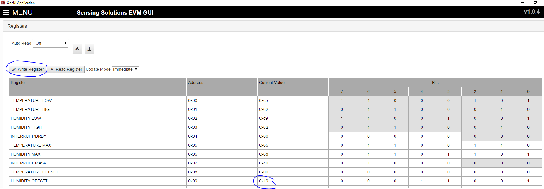

  • Dear Shinichi -
    since you now indicate that you are using EVM and it is consistently 5% lower  - then the offset register can be used to correct this.
    this is register 0x09 in the HDC2010 device. Please see page 23 here ==>
    in the GUI, you can set it for +4.9% to raise it up by setting this register to 0x19, writing the value, then begin measurements again
    like this:
