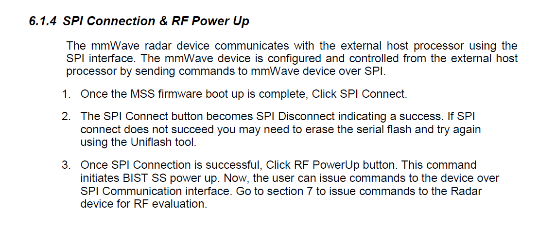

Alex, this is what the mmWave studio user guide says.
I tried flashing the firmware in C:\ti\mmwave_studio_02_00_00_02\rf_eval_firmware folder - radarss and masters - using the uniflash tool (Load Image) and I am getting errors continuously. Is there a solution to this? The tutorial video says SPI connectivity issue is because of firmware bugs.

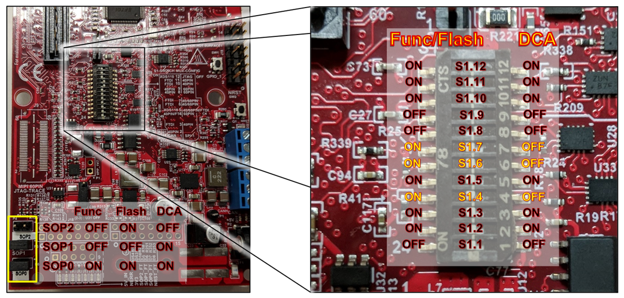

Hi Vijay,
Can you please try running the IWR68943ISK board in functional mode, and let me know if this works. You will need to change the MUX and SOP settings, and then run in mmWave studio. I've included an image with the settings for functional mode.
I've also attached the design files for the IWR643ISK board, so you can check that you are probing the correct SPI lines.
-Chloe
Hi Chloe,
I switched off the mmWaveICBoost and put the mux and SOP jumpers in the position that you suggested. The NERR light is always ON. Even repeated presses of the NRST switch doesn't help. And when I started the mmWave Studio, the BSS firmware successfully flashed while the MSS firmware doesn't get flashed. Is the board faulty? This is my output on the scope on the 0 ohm resistor R9 (SPI_CLK1).

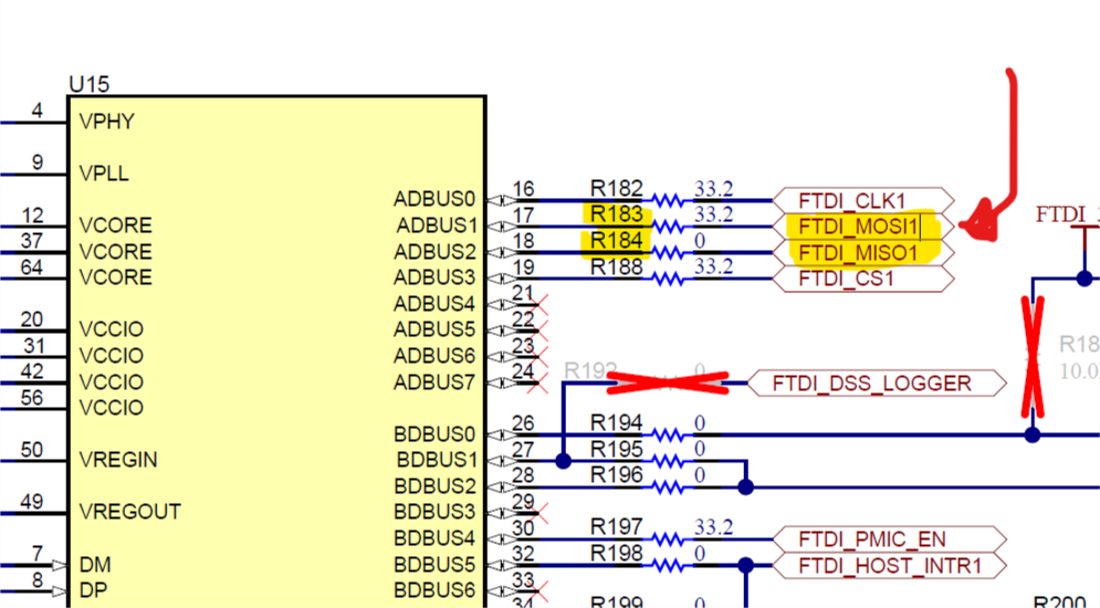

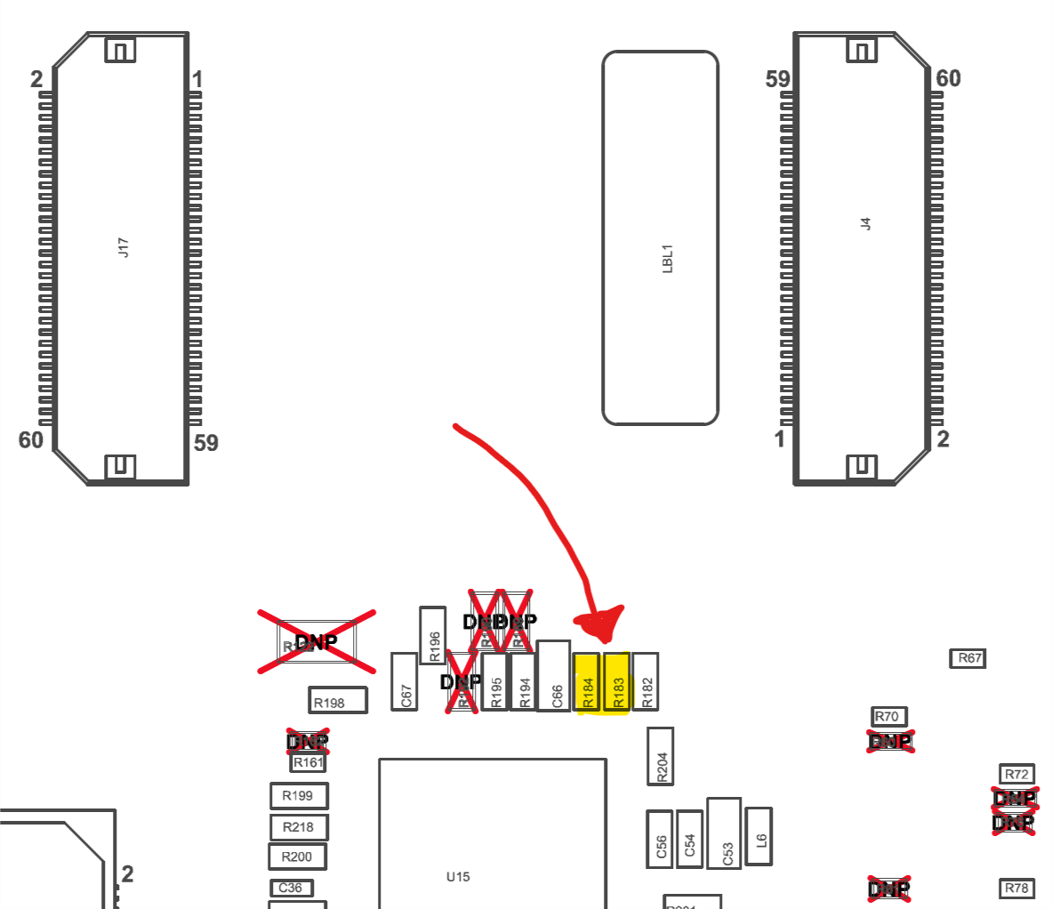

Chloe,
I have attached the picture of what I see on the probe on lines R184, R183. You can see from the picture that it is in Standalone mode with DCA disconnected. I have basically done every debugging step you've asked me to. If there is a fault in this board, please send us a new one with every module tested.
