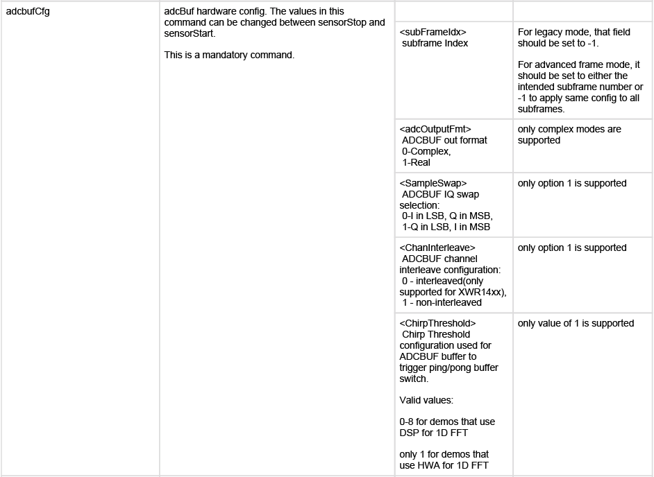

I'm going through the "mmwave_sdk_03_01_00_02" for AWR1843 and observed that the ADC buffer configuration, "MmwDemo_ADCBufCfg::iqSwapSel", is configured with 1 from mmWave visualizer.
But for AWR1642, this value is 0. The same has been noticed in the "mmwave_sdk_user_guide.pdf" in the docs folder.
Why is this change suggested? Is it because of hardware accelerator?
What is the format supported by hardware accelerator?
Is it possible to change the I/Q format for hardware accelerator?

    Can you confirm if visualizer is sending CLI command having 'adcbufCfg:SampleSwap' set to 1?
    As SDK supports only value '0' for this parameter.

    PFA the screenshot of pdf and the config file generated with the mmwave visualizer.
    Chidvilas

  • Hello Chidvilas,
    The OOB demo in MMWAVE-SDK for the AWR1843 illustrates the use of both the DSP and the HWA in the demo.
    For the ease of implementation only the swapsel:1 is supported.

  • Hello Raghu,
    Thanks for info.
    In HWA params configurations, only the macro "HWA_SAMPLES_FORMAT_COMPLEX" is seen, this only configures whether the sample is real or complex.
    But is it possible to configure HWA to configure for i/q swap?
    What is the format supported by HWA?
    Chidvilas

  • Hi
    The input to the HWA is I/Q. This is dedcribed in the Input Formatter section in UG
    Thank you
    Cesar
