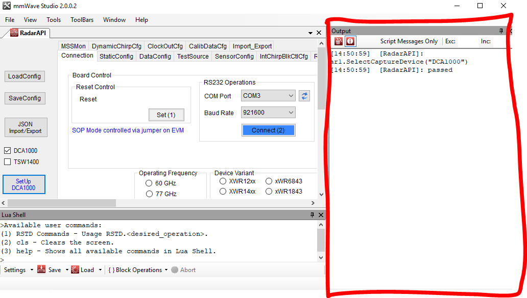

  • Mateusz,
    We need the other log as well, if you click on view then Output, you can copy that log and send it as a txt file.
    below is an image of the output window.
  • Alex,
    in Zip file that I have posted recently there is a folder with log files. These are OUTPUT log files  and the content is the same as what is in the "output" window
    Today I have repeated it for double check
    the zip file contains "log" folder with the output log files and also with *.rtf file where I have made ctr C + ctr V from output window.
    The raw data   is also added to zip file.
    mmwave_example.zip
