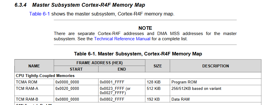

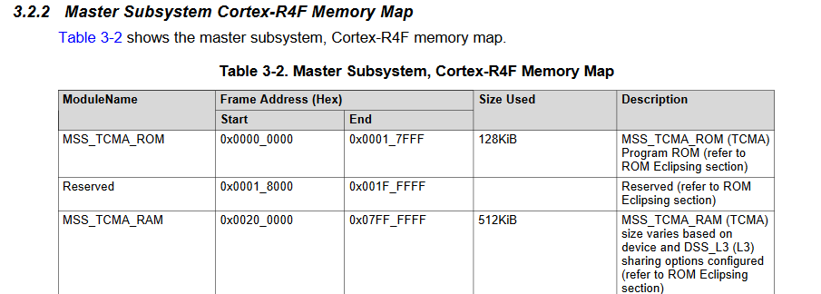

    Thanks for sending the additional details; i agree with you that your second linker CMD file contains something that actually makes sense when loading code to the device: the TCM RAM-A starts at address 0x200000.
    I couldn't really pinpoint the exact reason why the SDK linker CMD file would try to place the Interrupt Vector Table at address 0x0, unless the device has a configuration that overlays this internal Bootstrap ROM with an external RAM/Flash memory.
    With this in mind, I opened the device's Technical Reference Manual (SWRU522) and the same memory map table has an additional note:
    Searching the document for "Eclipsing", I found the explanation:
    Therefore, the device indeed has a mode that overlays the ROM bootstrap code and it seems to be executed at the end of this bootstrap. However, I lack the additional knowledge the device experts have about the whole boot process.
