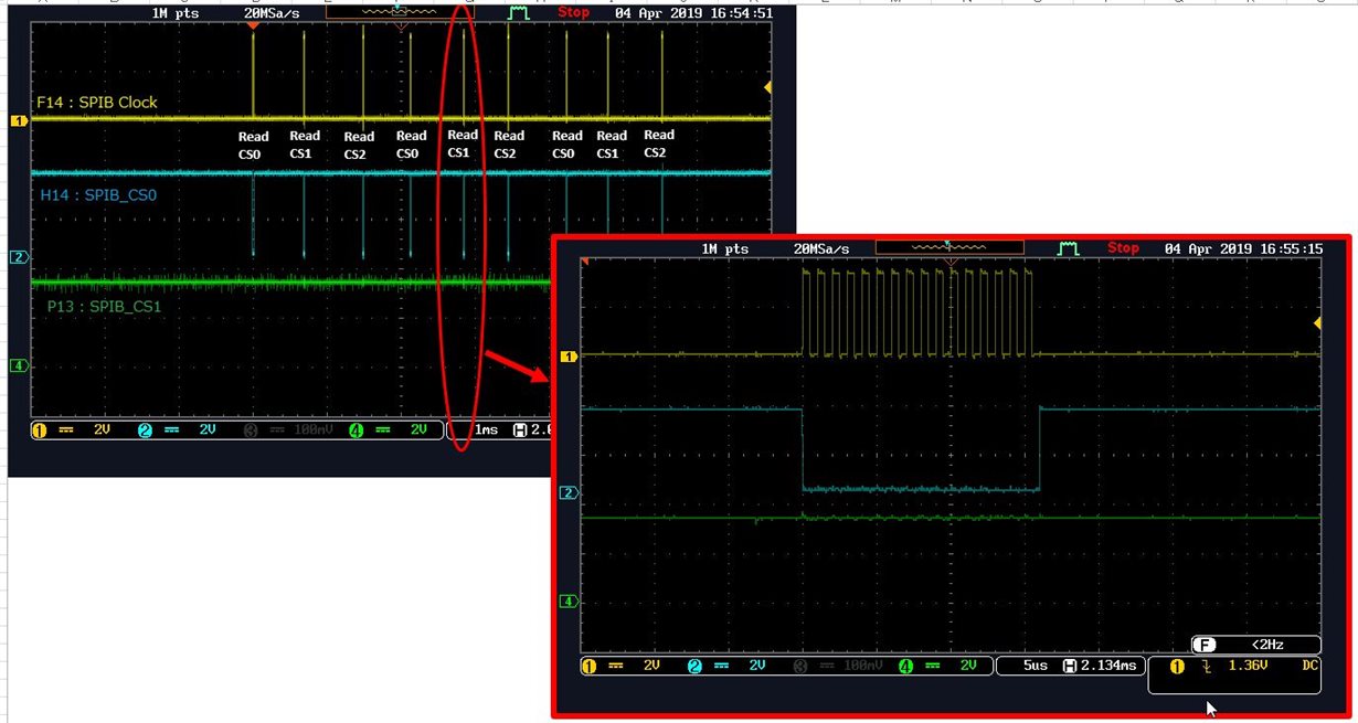

hi
I want to connect 3 devices to SPI_Bport and switch control with ChipSelect[0/1/2].
I tried SPI Read while switching ChipSelect CS0/CS1/CS2, but CS0 is always enabled. CS1 and CS2 doesnot work.
Steps
1. Enable SPIB pin settings
  refer : [Pin_Map] and [Pin_MuxSetting]
2. Set SPI parameters.
 refer : [Parameter_Setting]
3. Try to access CS0/CS1/CS2 with SPI_Read command
 a. SPI_Read with CS=0
 b. SPI_Read with CS=1
 c. SPI_Read with CS=2
 Repeat a>b>c.
 refer : [TestCode]
4. As a result of checking the waveform, CS0 is always enabled. Even if it accessed CS1/CS2.
Are there any problems with the procedure for test steps?
or Is there any other root cause?
