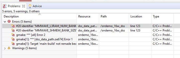

Hallo,
How can I build the mmWave demo in ccs 9.
My version of mmWave SDK is:
mmwave_sdk_02_01_00_04
Error:
console output:

>> Compilation failure
subdir_rules.mk:9: recipe for target 'dss_data_path.oe674' failed
"../dss_data_path.c", line 123: error #20: identifier "MMWAVE_L3RAM_NUM_BANK" is undefined
"../dss_data_path.c", line 123: error #20: identifier "MMWAVE_SHMEM_BANK_SIZE" is undefined
2 errors detected in the compilation of "../dss_data_path.c".

    For SDK 2.1 there is no ccs project provided for the SDK oob demo.
    I recommend you modify the ccs project provided for SDK 2.0 oob demo. You will need to modify the project spec (one file)
    This ccs project is available in the Industrial Toolbox 2.5.2, mmWave SDK Demo 16xx
    In order to access this older version of the Industrial Toolbox please click on Package Picker (icon next to Search Window)
    Thank you
    Cesar
