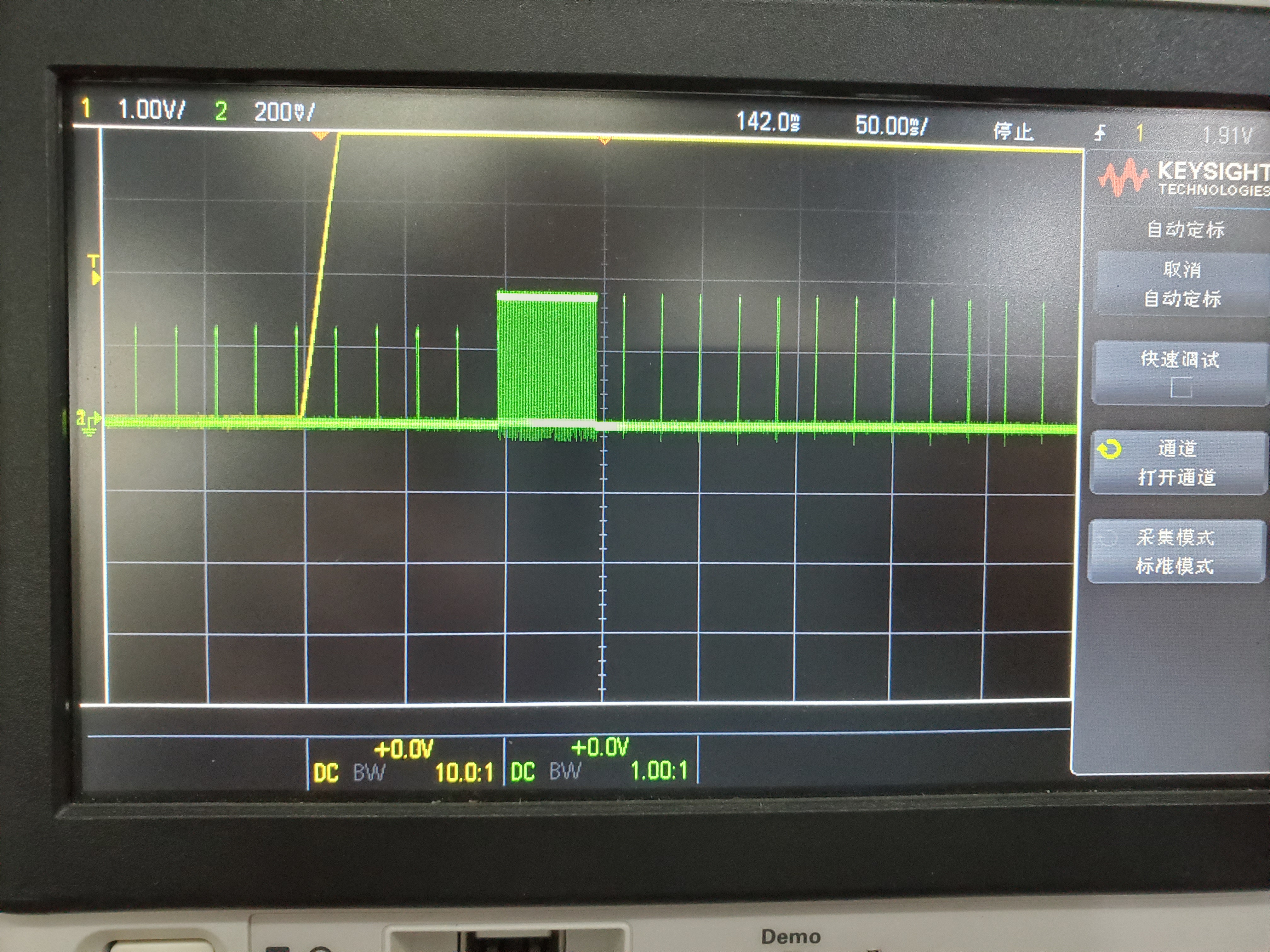

    This is our test hardware setup. We use N5/N4 as CAN Tx and CAN Rx.
    When we start 1# AWR1642, it works well with no error frame. And we start the other AWR1642, the signal between CANH/CANL seems not right. It will raise a lot of error frames like the picture shows below:
    The signal in the center of the scope of green is the error signal. The yellow one is the apply power of AWR1642. The signal has a frequency of approximate 11.6KHz, it seems a uart signal transmitted via CAN TR. Since N5/N4 are natively used as uart port in bootloader. I think this has something to do with bootloader.
     How can I avoid the error frames sent by AWR1642 when boot? And what is the startup logic of AWR1642 bootloader, Thank you!
