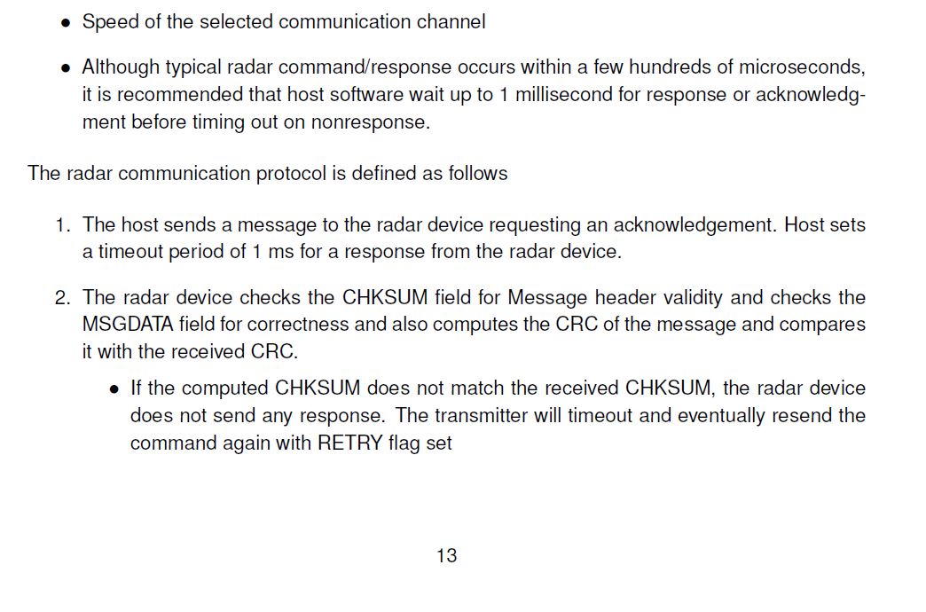

Question 1: In the document "AWR1xxx_Radar_Interface_Control.pdf" document page 14, it says the host starts a Retry Timer (~1 ms). Can this retry time be increased for debugging? Since sometime I want to print out things that take longer than 1 ms, without causing a time out.

    1. You can set ack timeout value before calling rlDevicePowerOn.
    clientCtx.ackTimeout = 5000;
    retVal = rlDevicePowerOn(deviceMap, clientCtx);
    2. After the PowerOn and getting the 'RL_DEV_AE_MSSPOWERUPDONE_SB' Async-event, I suggest invoking another API instead of filedownload to verify that the device responds to the command. Invoke 'rlDeviceGetMssVersion' instead and check if device responds with the ACK.
    Jitendra
  • Regarding 1: This timeout is already set to 1000ms. But in the document it says it's 1ms and I get timeout error if I go beyond `1ms:
    Can this be changed to a longer timeout?
