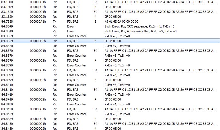

    1. When i send a command to AWR1642 to let it send data by CAN-FD,and the next package was lost(time stamp 84.8349 in fig.1).
    Then the stuff error is caused, and the status was changed from "0x000E000F" to "0x000E340F".
    The LEC is 7,and the DLEC is 4.

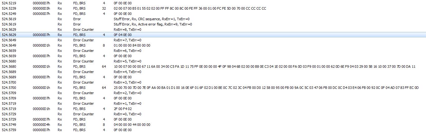

    2. When the AWR1642 send a package to PCAN-View by CAN-FD,the package is lost (time stamp 542.5619 in fig.2).
    The stuff error is caused, and the status was changed from "0x000E000F" to "0x000E040F".

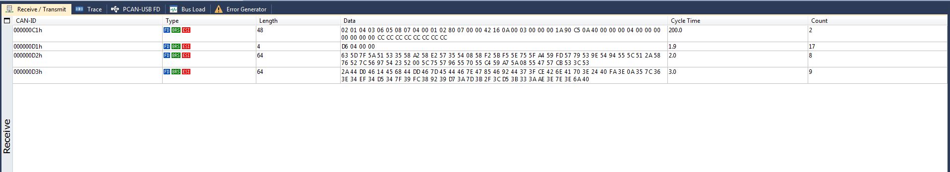

    PCAN-VIEW send a command to AWR1642.
    AWR1642 send packages to PCAN-VIEW
