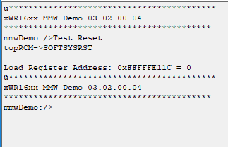

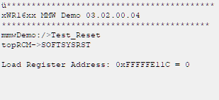

  • I have a same trouble , can reset AWR1642-EVM but AWR1642-HS  didn't
  • Hi Jitendra,
    static int32_t ARadTek_TEST_Reset (int32_t argc, char* argv[])
        CLI_write ("topRCM->SOFTSYSRST \r\n");
        uint32_t* SOFTSYSRST_Addr = (uint32_t*)0xFFFFE11C;
        CLI_write ("Load Register Address: 0xFFFFFE11C = %X \r\n", *SOFTSYSRST_Addr);
        *SOFTSYSRST_Addr = 0xAD;
    We make a new function in mmw_cli.c.
    When we load command with UART, it will run the function.
    I read this in AWR1642-HS.
    I read this in AWR1642.(none HS)
    After it can't reset successfully  in AWR1642-HS, it will be broken.
    JuiYang

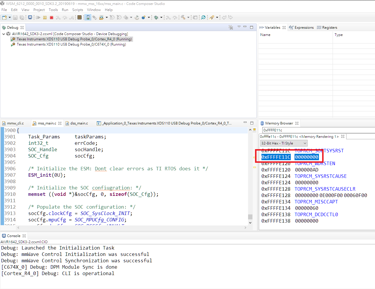

    Is this possible for you to flash ccsdebug.bin first to HS device, then connect CCS to manually write that register and see the effect?
    Jitendra
  • Hi Jitendra,
    Thanks for your advice. I try it.
    When I change TOPRCM_SOFTSYSRST(0xFFFFE11C) to 0x000000AD, I can't see nReset blinking.
    But I can see nERROR_OUT(N6) blinking continuously.
    JuiYang
  • Hi JuiYang,
    Based on recent information from the team, reset to AWR1642 HS device via writing this register (warm reset) is not possible.
    You need have some external mean to reset the AWR1642 device.
    It can be external watchdog (based on PMIC or MCU) or via nError pin monitoring of the device.
    Refer this Errata: https://www.ti.com/lit/er/swrz089b/swrz089b.pdf (topic: MSS#34)
