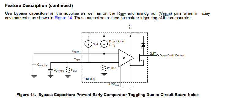

TMP300: Start-up characteristic
Part Number: TMP300
We have a TMP300 with TSET = 523K (trip point ~ 107C). At room temperature (27C) we are seeing start-up behavior where V+ rises to 12V and the Vtemp output rises to ~ 2V corresponding to ~ 150C for about 4-5msec. Later (20msec +) the Vtemp settles  to ~ 0.78V or ~ 28C.
Is there a specified time where the device will not provide accurate temperature information during power-up? Is there a way to configure the device to avoid false triggering at power-up?
