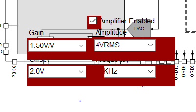

    1. Increase the Exciter amplifier gain. You can choose the highest gain.
    2. Try selecting the 7Vrms output
    3. Change the resolution to 8 bits by connecting the BMODE0 to ground.
    Let me know if any of these help?

    We tried to increase the exciter output to 7V RMS however our Vext is 12V, and based on datasheet, in this case 4V RMS recommended - no better result.
    We try to increase the exciter amplifier gain and to reduce the resolution to 10 bit, but AB output still noisy.
