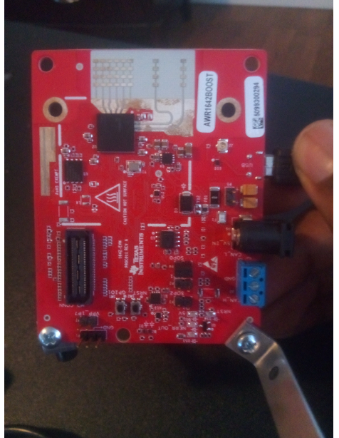

AWR1642BOOST: OOB demo auxiliary com port -waiting on data.
Part Number: AWR1642BOOST

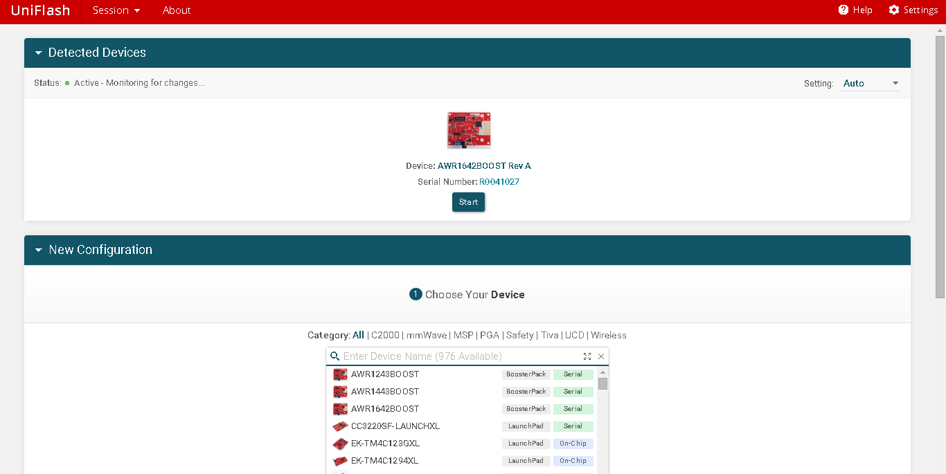

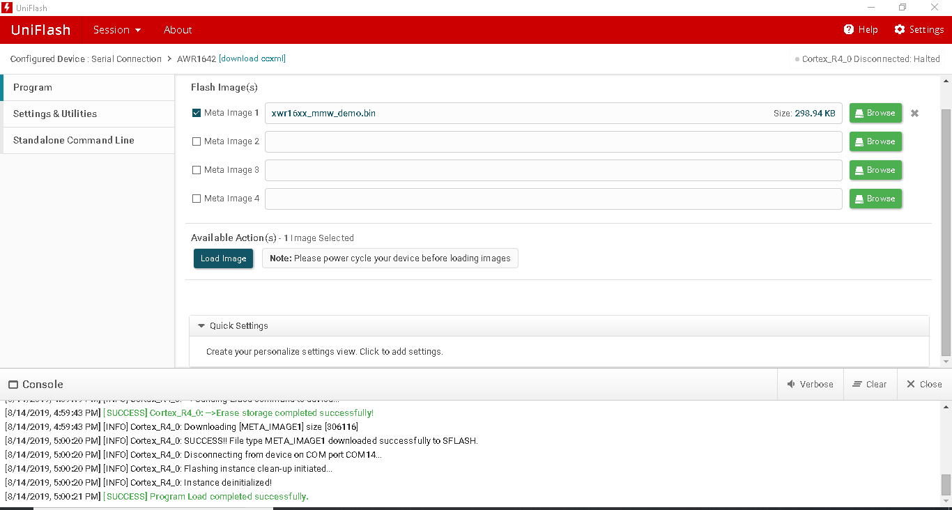

I'm trying to run the OOB demo using the online demo visualizer. I'm getting stuck after I set up my com port and press configure. The auxiliary com port gets stuck on "waiting for data". I have re flashed the OOB using the uni flash follow the flash instructions in the sdk user guide. First I put jumpers on SOP0 and SOP2  and power cycled the device and press the GPI01. Then using the uniflash application I format flash the device then load the xwr16xx_mmw_demo bin file to the device. Then I removed the SOP2, power cycled and pressed the GPI01 again. Last I tried to run the demo. Did I do something wrong? Is is possible  the device is faulty? I did have problems for a while  just getting the comports to connect.
I'm using mmwave_sdk_03_02_00_04

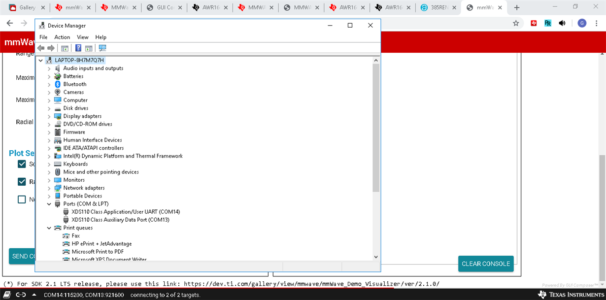

  • Christoper,
    Please make sure you are using a power supply that provides 5V and at least 2.5A.
    In the mmWave Demo Visualizer, did you also make sure to select the right COM ports for your device?
    This is done by going to "Options" --> "Serial Port"
    Then you need to select the ports based on the COM ports that show up in Windows Device Manager.
    From the images that you uploaded in you previous post, I could select the following options:
    CFG_port: COM14
    DATA_port: COM13
    Kyle
