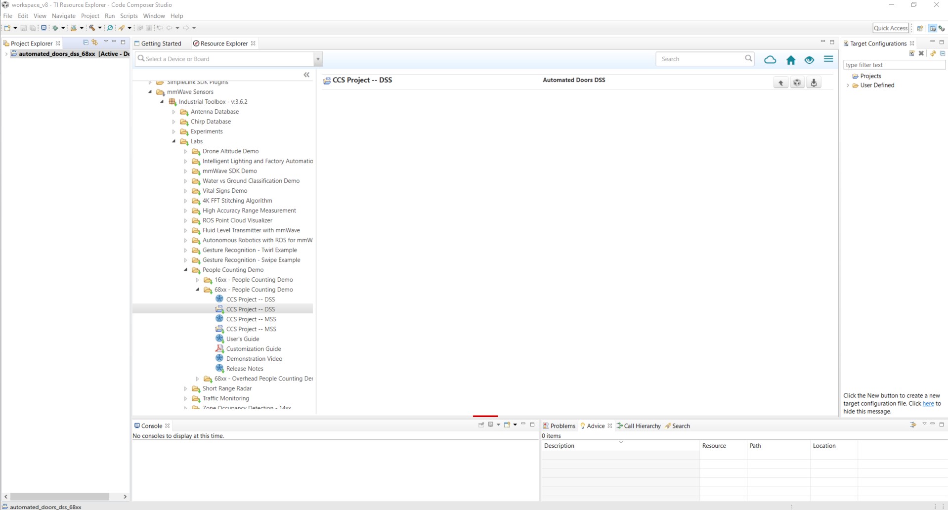

When trying to import the MSS or DSS projects files for the people counting lab (lab15) inside the industrial toolbox v3.6.2, CCS end up importing the automated door project files instead. See screen shoot below.
Hi Mustafa,
Thank you for pointing this out, we are working to fix this.
In the mean time you can manually download the industrial toolbox and import the .projectspec file from the people counting 68xx folder. Steps to do this are included in the People Counting User Guide.
Let me know if anything is unclear or you have more questions.
