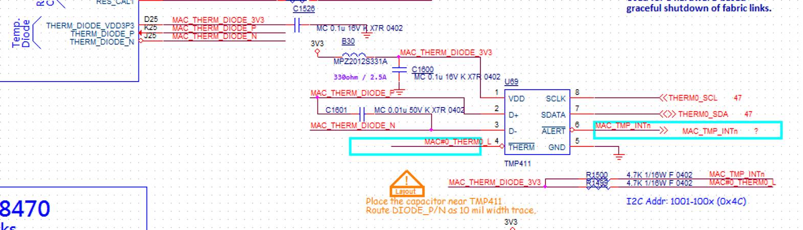

The customer use TMP411 to replace ADM1032.(The ADM1032 work fine here)

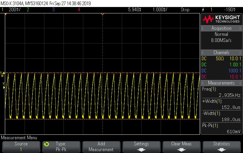

But the remote temperature can’t be read, and it shows around 0 degree C at room temperature.
Could you help to check is there anything we need to be verified?
