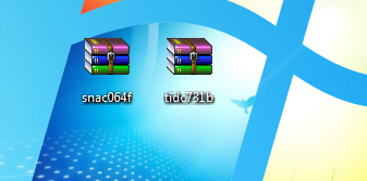

Now ı am explaning what i did step by step;
1) I instal the program which name is "tidc731b"
2) I removed this because of that it doesnt run anyway.
3)I instal the program which name is "snac064f"
4)Happened same problem
Note: Both of this folders(.zip) are downloaded from your site.
