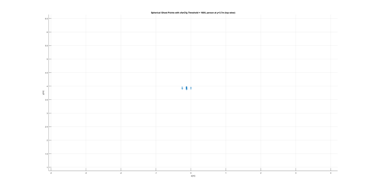

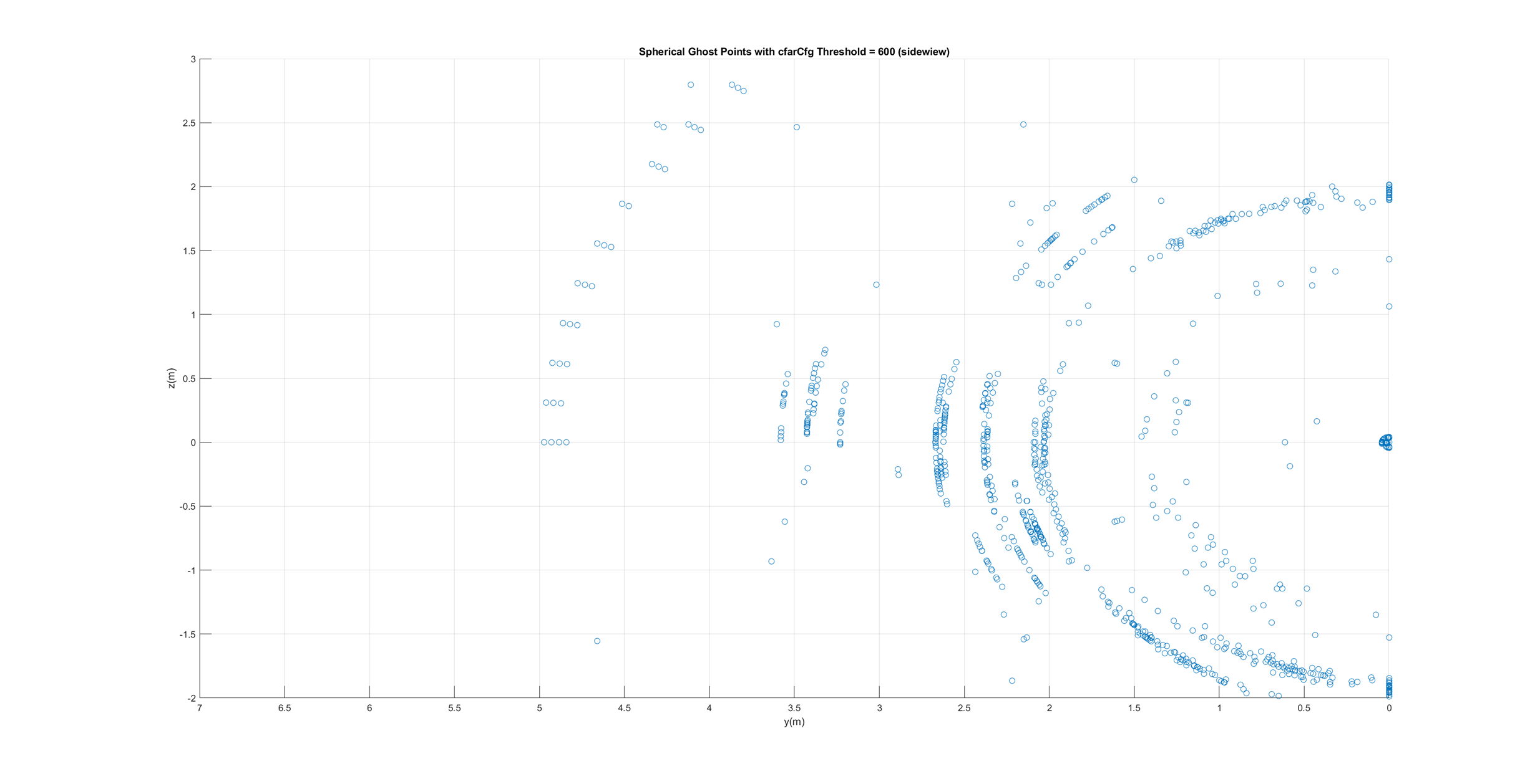

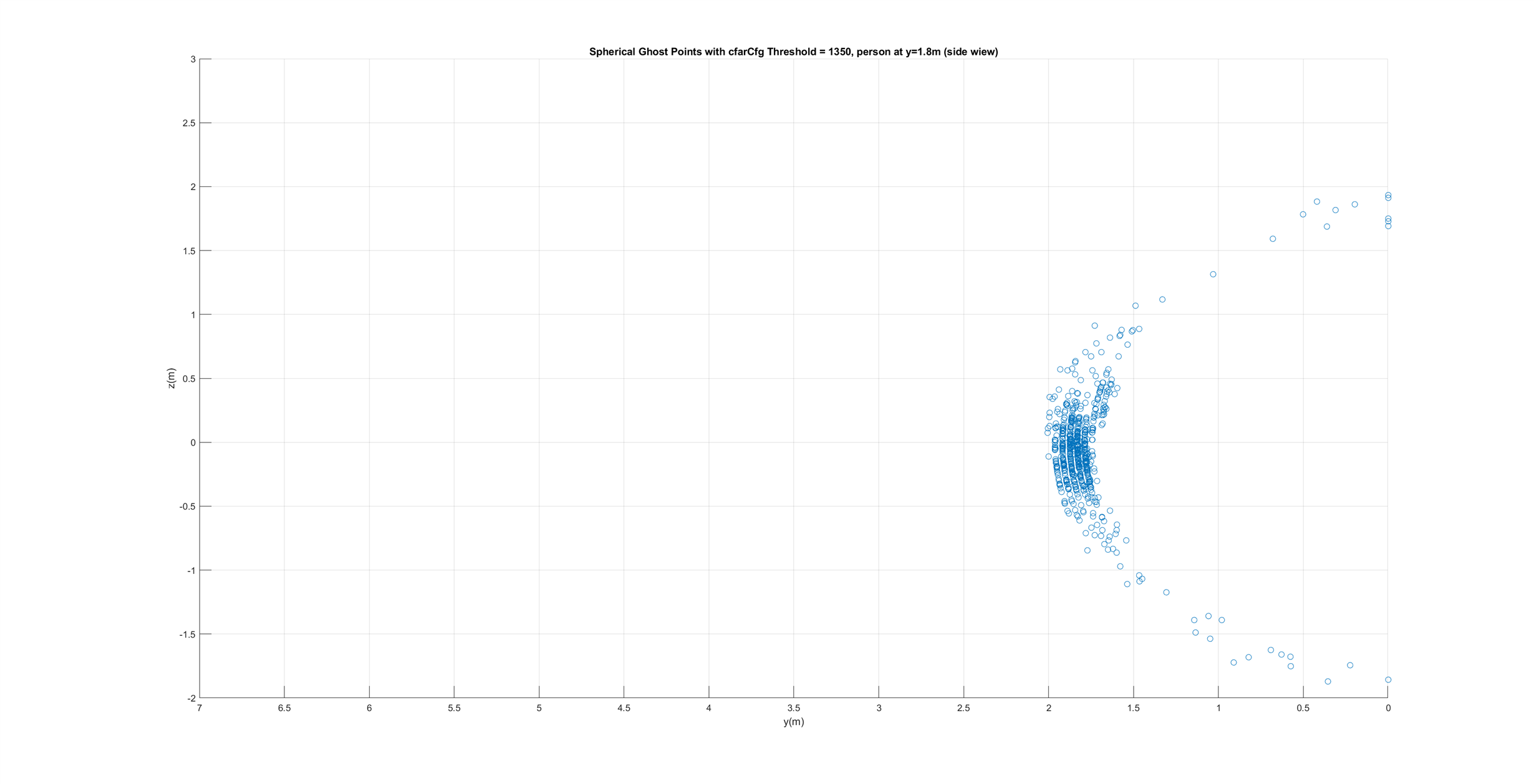

I encounter some issues with ghost points that are organized in a spherical cloud around the origin for low thresholds. That is, if measuring with no object in front of the sensor the following is observed for a cfarCfg Threshold of 600 (image below, especially side view):

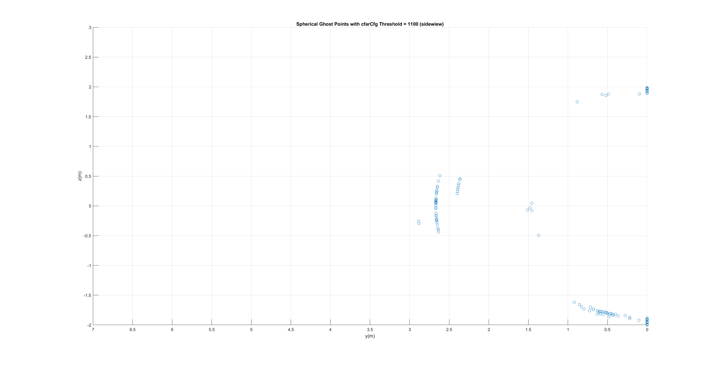

If I increase the threshold then less ghost detection happen but they are still in a spherical cloud for a cfarCfg Threshold of 1100 (see image below):
If the threshold is once more increased such that no ghost points are detected with no object is in front of the sensor then this spherical ghost points appear again if a person is standing close to the sensor (e.g. 1-2m). In the image below there again are spherical organized ghost points where the person is standing at approx 1.8m in y-direction (cfarCfg Threshold = 1350).

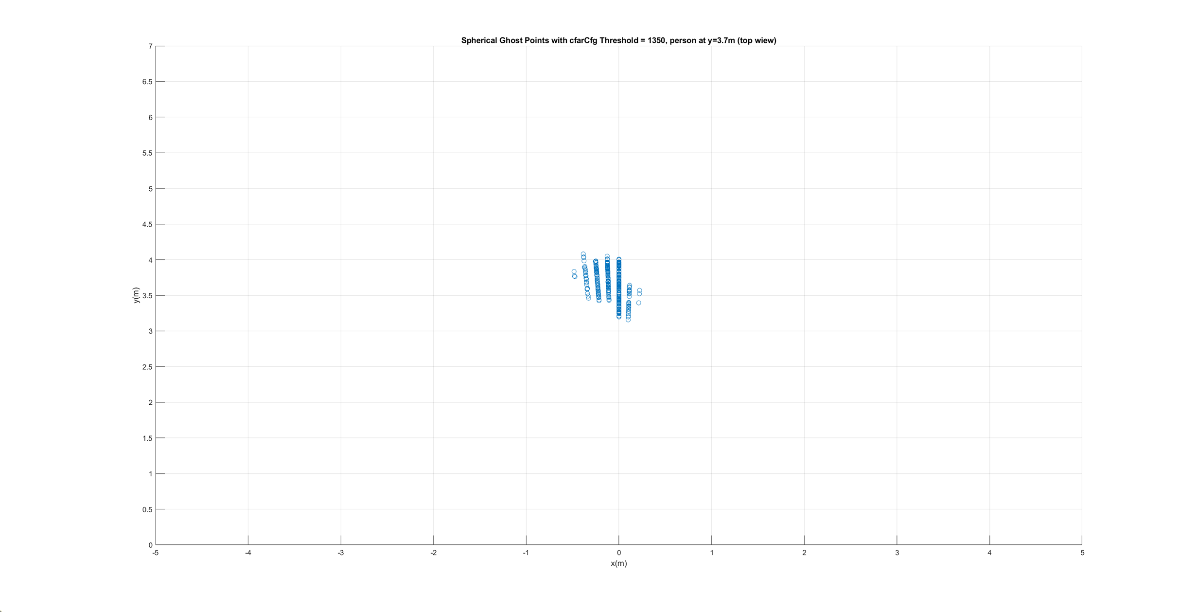

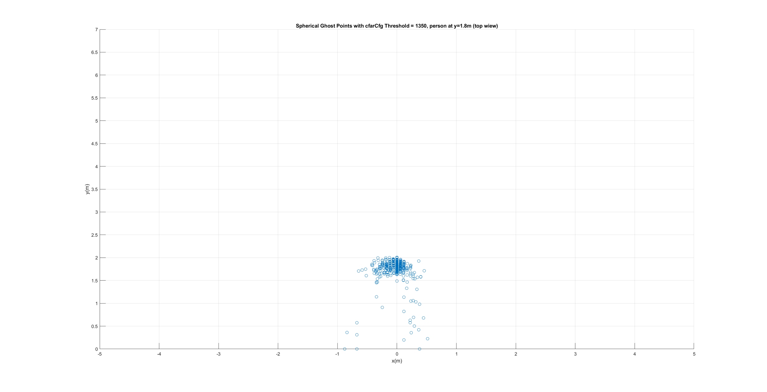

However, with the same setting but with the person standing at approx 3.7m in y-direction no spherical ghost points were detected (see images below):
The following configurations were used where the last value in the line of cfarCfg was changed according to the mentioned thresholds:

Concluding, the following observations are made:
  • For low thresholds there are always spherical organized ghost points even in an empty room
  • For higher thresholds there are no spherical organized ghost points in a empty room but still for person standing near the sensor
  • The spherical organized ghost points don't appear if the person is standing at a larger distance to the sensor
Hence the following questions arise:
  1. Can these spherical ghost points be eliminated, and if so, how can it be achieved?
  2. What is the optimal way to position the sensor in a room?
Thanks for your answer.

    Regarding increasing the threshold, I already did this resulting in a more focused point cloud (see image below for a cfarCfg Threshold of 1600). However, if I increase the threshold more and more there are no detections of a person that is still inside the max. unambiguous range in front of the sensor.
    Yes I agree that these points could be reflections of walls, floor or ceiling. However, there arise some questions:
    1. Why is the e.g. the ceilling not detected as a plane but as a spherical point cloud?
    2. Why is there no such detection of ceiling,floor, walls if no person is in front of the sensor but these "spherical outliers" if a person is standing right in front of the sensor?
    I will test the sensor with antennas facing the sky outdoors, as you suggested. Howerver, ultimately the sensor is planned to be used indoor. Therefore is there a way to deal with this spherical detection issue?

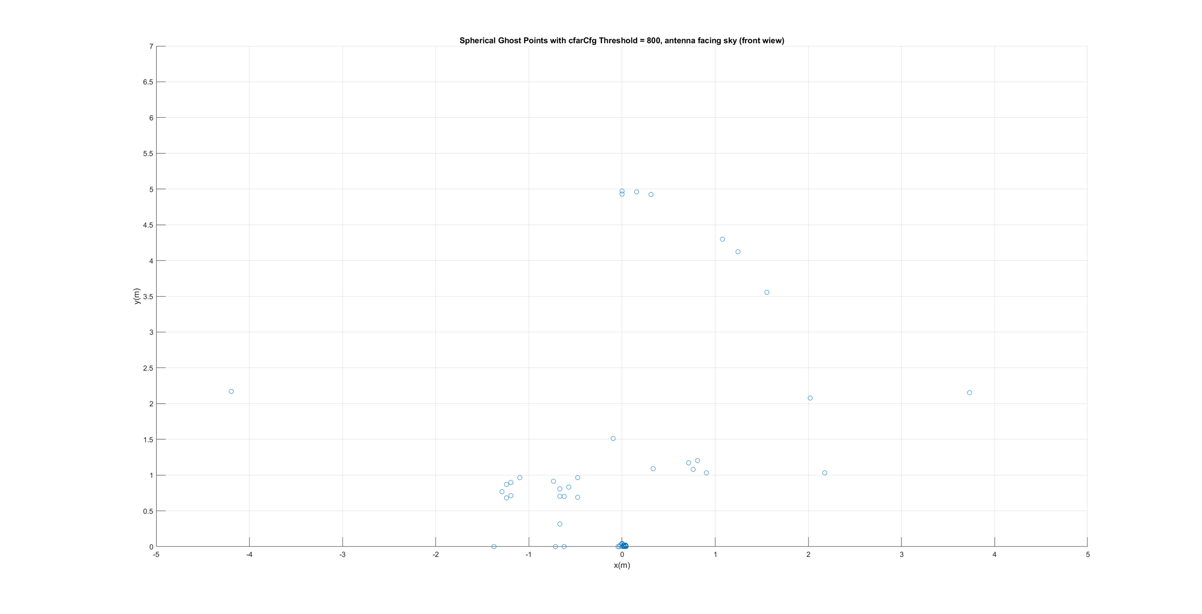

    I now did the outdoor measurement with the antenna facing the sky. There were no obstacles in the field of view of the sensor.
    The following was observed with a cfarCfg Threshold of 400. Y-axis is pointing towards sky:
    There are also this spherical detections even though no object or walls are near the sensor. For a cfarCfg Threshold of 800 it looks as follows:
    There are also some spherical detected points.
    For a cfarCfg Threshold of 1000 there are only very view detections. For a cfarCfg Threshold above 1100 there are no detections.

    Let me resume the observations made so far and the open questions:
    1. Observation: For low threshold values there are points detected that are organized in a spherical manner even though there is no object in front of the sensor. You suggested these points are reflections from wall/ceiling/floor. My expectations of of wall/ceiling/floor reflectiosn would be more planar shaped point clouds and not spherical shaped. How can this be explained?
    2. Observation: Increasing the threshold to a value to approx. 1350 there are no detections in the empty room (this is the goal). If, however, a person is standing in front of the sensor, i.e. 1-2m distance, there is a point cloud with a high densitiy where the person is standing but additionaly there are also spherical organized points towards the sensor detected (see figure above "Spherical Ghost Points with cfarCfg Threshold = 1350, person at y=1.8m"). If the person is standing at a larger distance to the sensor there are no spherical organized deteced points but only the ones belonging to the person. How can this be explained?
    3. Observation: These spherical organized detections were also made for low threshold values (e.g. 800)  outdoors when the antennas were facing the sky, as you suggested to do.
    4. Question: What is the optimal way to position the sensor indoor?
    Best
